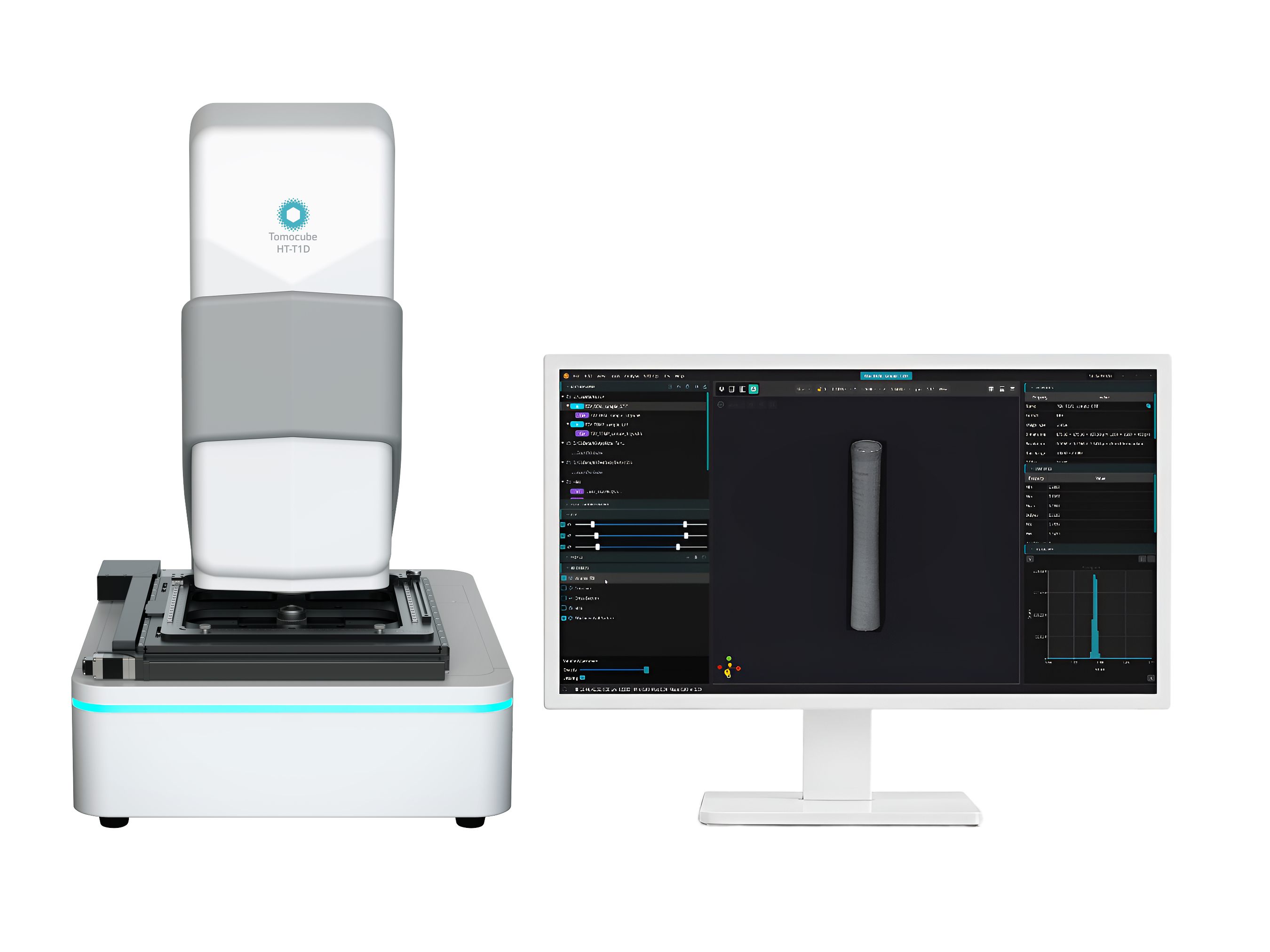

(Tomocube: Daejeon, South Korea) -- Tomocube, a 3D nondestructive inspection and metrology company, has launched HT-T1 Desktop (HT-T1D), a desktop holotomography system for high-resolution 3D defect analysis of glass substrates used in next-generation semiconductor packaging.
HT-T1D is optimized for glass-substrate inspection and metrology workflows. When conventional in-line panel inspection tools, such as automated optical inspection (AOI) systems, flag a potential defect, HT-T1D takes the corresponding coordinates and reconstructs the interior of the glass substrate in three dimensions, resolving the location, morphology, and depth-wise characteristics of defects that surface inspection alone can’t reveal.
Glass core substrates and glass interposers are gaining attention as key enabling materials for AI accelerators, high-bandwidth memory (HBM), and other advanced packaging applications. As these substrates move toward mass production, however, manufacturers face mounting challenges in identifying the root causes of microdefects introduced during complex process steps such as laser drilling, etching, metallization, and singulation. A single critical defect can scrap an entire unit. As a result, being able to quickly turn inspection data into process improvements has become critical to production-line stability.
HT-T1D applies Tomocube’s visible-light holotomography to visualize the three-dimensional refractive-index distribution inside glass with a refractive-index sensitivity of 10⁻⁴. Because the measurement is nondestructive, the same location can be measured repeatedly during successive process stages, enabling users to track when and how a defect forms, propagates, or enlarges. The system is expected to shorten defect-analysis cycles that have traditionally depended on destructive failure analysis. This reduces analysis time from days or weeks to minutes in applicable workflows and supports earlier intervention ahead of high-cost downstream steps.
Alongside the hardware, Tomocube also introduced TomoAnalysis MI (TAMI), a dedicated 3D analysis software platform for metrology and inspection. TAMI quantitatively analyzes 3D refractive-index volume data and generates structured reports for engineering review. It also processes data from HT-T1M, Tomocube’s planned in-line module for deployment through system integration partners, in the same format—providing a unified workflow from R&D investigation through production-line review.
“Glass substrates are emerging as a critical material for next-generation semiconductor packaging, but true competitiveness in mass production will depend on how quickly manufacturers can understand defects and translate that understanding into process improvements,” says Yong Keun Park, CEO of Tomocube. “HT-T1D goes beyond defect detection, helping customers identify root causes and refine process conditions. We believe it will become an essential metrology platform for accelerating yield learning in glass-substrate manufacturing.
“The same platform can also address glass photonic integrated substrates for co-packaged optics (CPO), where the refractive index itself directly affects device performance. This expands its applicability beyond defect analysis to areas that require functional metrology.”
With the launch of HT-T1D, Tomocube will engage glass-substrate manufacturers, advanced-packaging companies, and system integration partners to support 3D defect analysis, process review, and yield-learning workflows for glass-substrate manufacturing. The company will also continue to expand its glass-substrate inspection and metrology portfolio, including future in-line deployment through system integration partners, as it addresses the growing demand for defect-analysis and yield-learning solutions in advanced semiconductor packaging.
