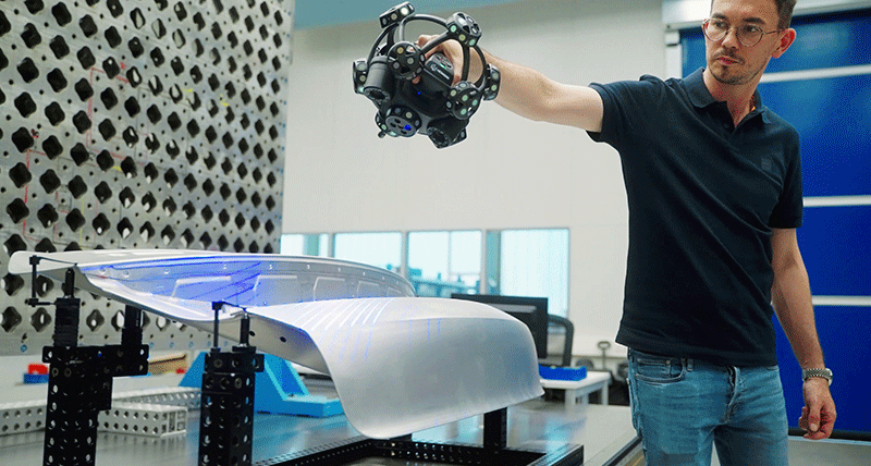

(Hexagon: Cobham, England) -- Hexagon’s Portable Metrology Division has introduced HYPERSCAN SR, a fully wireless optical-tracking 3D scanner that makes professional optical tracking more accessible. Combining a fully wireless workflow, simple operation, and dynamic tracking in a portable solution, it can be used directly on the shop floor, at supplier sites, or in the field.
Industrial engineering teams increasingly inspect parts where they sit—on the production line, at multiple sites, and in service—rather than carrying them to a measurement room. Optical tracking holds a measurement steady when the part or its surroundings move, but it has typically needed cabling, careful setup, and a metrology specialist to operate. The HYPERSCAN system eliminates that setup burden with dynamic optical tracking—a technology that unifies the scanner and the part in one coordinate system so the scan remains stable, even when the part moves or the setup vibrates.
HYPERSCAN SR is a fully wireless system with Wi-Fi 6 connectivity and swappable batteries built into the scanner and tracker; no tethered wireless accessory is required, and there’s no cabling to route. It deploys with minimal preparation and is straightforward for nonspecialist operators to run. When scanning, its dynamic tracking follows the part and the scanner together so movement and vibration don’t break the scan.
Darren Goh, product director for handheld 3D scanners at Hexagon, says, “Dynamic tracking makes HYPERSCAN SR quick to deploy and simple enough for everyday operators to pick up and use. Because it’s a fully wireless system, with Wi-Fi 6 and battery power native to the device, teams can bring it into limited-access and power-limited areas that a larger, cabled setup can’t reach.”
Target-free wide-area scanning helps operators improve their productivity measuring small and medium parts, such as welded machine frames, cast housings, tooling and fixtures, and vehicle interiors, with multiple scanning modes up to 4 million points per second, hole flash capture, and edge detection. The scanner weighs only 1.3 kg (excluding battery) with on-device controls and intelligent voice-assistant operator support. Finished point clouds can be exported to STL and common file formats, with one-click data transfer to Geomagic or PolyWorks.
