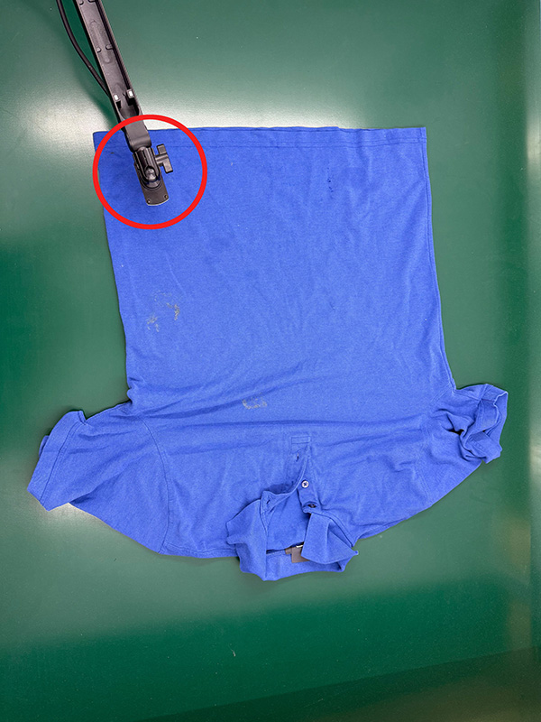

Initially, an object-detection model analyzes the images captured by the first camera mounted above the conveyor belt. It determines the type of garment, such as a T-shirt, trousers, or a dress. The second camera scans the garments again from a height of approximately five centimeters, focusing on material properties and detecting features such as stains or buttons. The identified image sections are cropped and passed on to a second AI model, which classifies the type of material, specifically distinguishing between woven and knitted fabrics. Finally, the analysis results are clearly displayed on a screen.
Analysis results are displayed.
