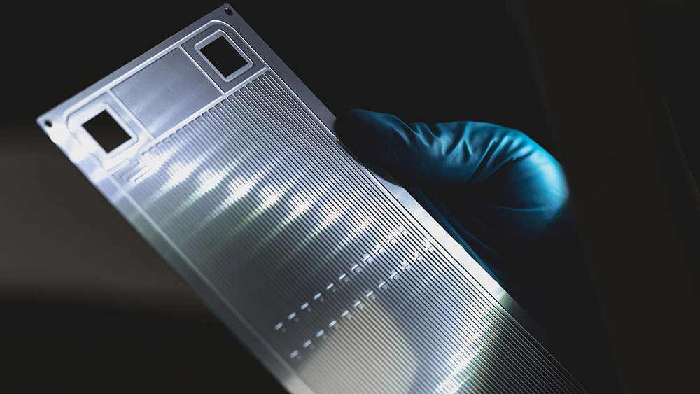

An alternative option is chemical etching, also known as photochemical machining (PCM). Unlike mechanical or thermal processes, this method removes material through controlled chemical reactions rather than force or heat.
A photoresist mask defines the component geometry, and the exposed metal is selectively dissolved using etchants. Because material is removed chemically, PCM avoids the deformation and thermal effects associated with conventional shaping methods.

A recent manufacturing review revealed that PCM is a stress-free process that doesn’t introduce residual stress, burrs, or deformation. Neither does it alter hardness, grain structure, or ductility, because no cutting forces or thermal loads are applied.
Research published in the 2025 Journal of Tribology also suggests that photochemical machining is a viable option for producing microstructures and precision components. This is while maintaining material integrity and avoiding the stress and deformation associated with conventional manufacturing methods.
Another advantage is tooling flexibility. Chemical etching uses phototools, rather than hard tooling like dies or punches, that can be created quickly and modified easily for faster design iterations and lower tooling costs. Because phototools don’t have mechanical wear, they also maintain accuracy throughout production.
