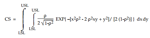

As we learned last month, the precision to tolerance ratio is a trigonometric function multiplied by a scalar constant. This means that it should never be interpreted as a proportion or percentage. Yet the simple P/T ratio is being used, and misunderstood, all over the world. So how can we properly make use of the P/T ratio?
The usual motivation behind the computation of the P/T ratio is a desire to determine if a measurement procedure is adequate for a given production process. And there are two ways that measurements support a production process: They can be used to scrape the burnt toast (inspection), or they can be used to learn how to stop burning the toast (process improvement). If the measurement system is adequate to allow us to improve the process, then we can often get to the point where we no longer have to depend upon inspection to ship conforming product. So, of these two ways that measurements support production, the role of process improvement is the more critical in the long term.

1) It's a good basis to expand into using the Hotelling's T-square and multivariate QC.  We tend to think in spec "boxes". Referring to your Figure with tthe ellipse:   IF there is/are  correlation(s)  between two or more specs then the specifications should be based on the bivariate (or multivariate) distribution.  Looking at the "box" specification region in your figure, and imagne a point in the upper left corner -- both specifications are "met" BUT, it is way off the line formed by the ellipse.  The other case may be that the data values for x,y may be in the upper right corner and both values may be slightly outside the "square" specifications.  Hence, the question about 'Acceptance' should be:  Should I accept a product in the upper left corner (both specifications met, but way off the ellipse and the apparent line between the specs) OR the one in the upper right corner -- slightly OUT oF SPEC -- but well within the ellipse.
 In other words, the one in the upper LEFT corner has an additional problem by being so far from the ellipse and the line formed by the correlated variables.
