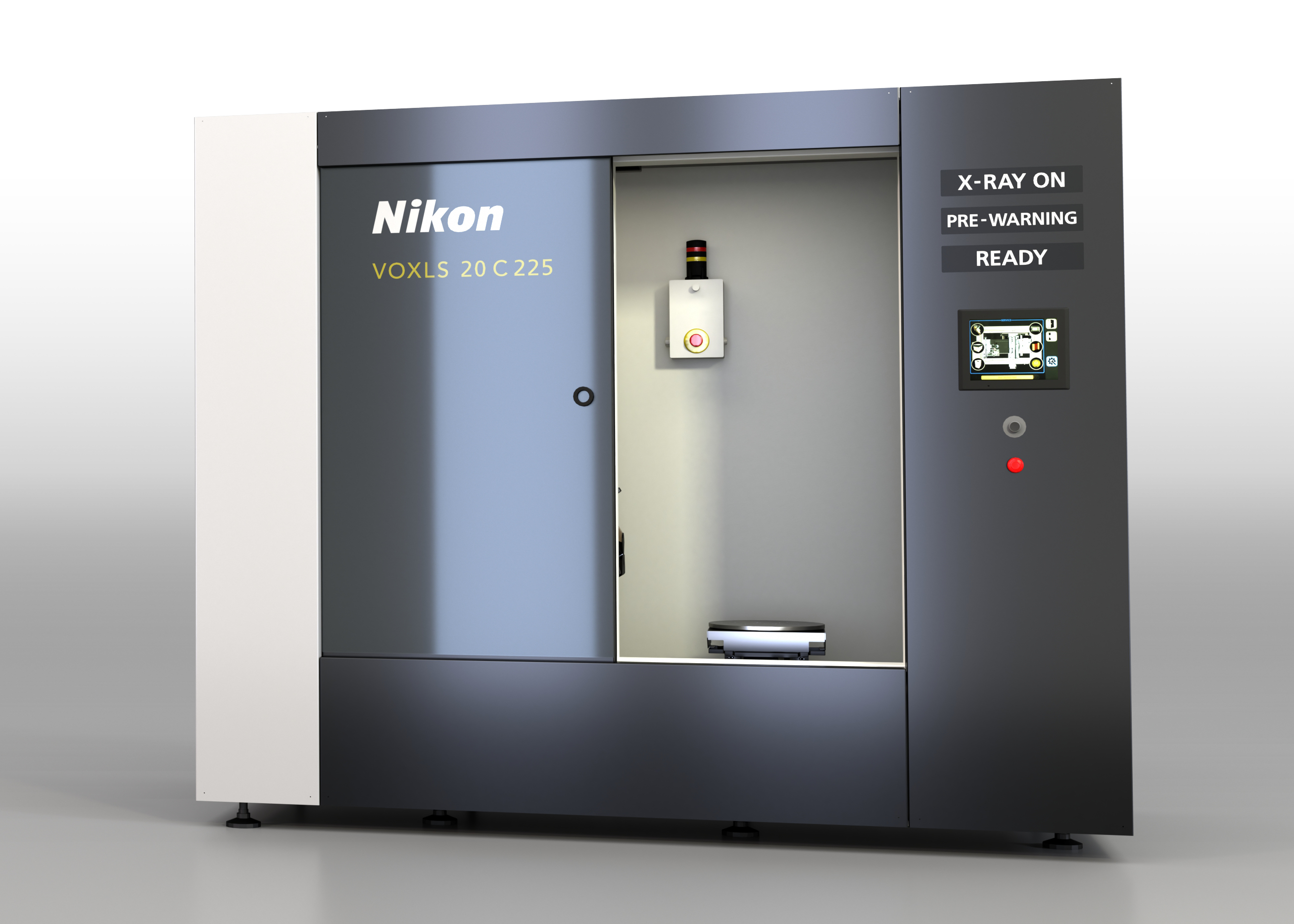

(Nikon Metrology: Brighton, MI) -- Nikon Corp. has launched the VOXLS 20 C 225, the latest addition to its VOXLS X-ray CT product lineup. This system is based on the proven principles of the company’s VOXLS 30 and 40 series systems while offering maximum capability in a space-efficient footprint, providing unparalleled value per voxel.
The VOXLS 20 C 225 offers the largest CT scanning envelope in a system that fits through a standard double door, allowing for flexible integration to almost any quality control laboratories and production environments.
The new system features Nikon’s metrology-grade platform with a granite base, rigid steel manipulator towers, and high-accuracy encoders and motors. These engineering choices ensure precision, repeatability, and reliability while delivering exceptional X-ray and CT data quality.
Key features
Superior CT inspection envelope: Offers an industry-leading inspection volume of 555 mm (dia) x 759 mm (H) in a compact footprint of just 2,451 mm (L) x 1,173 mm (D).
