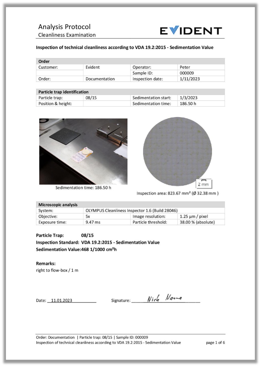

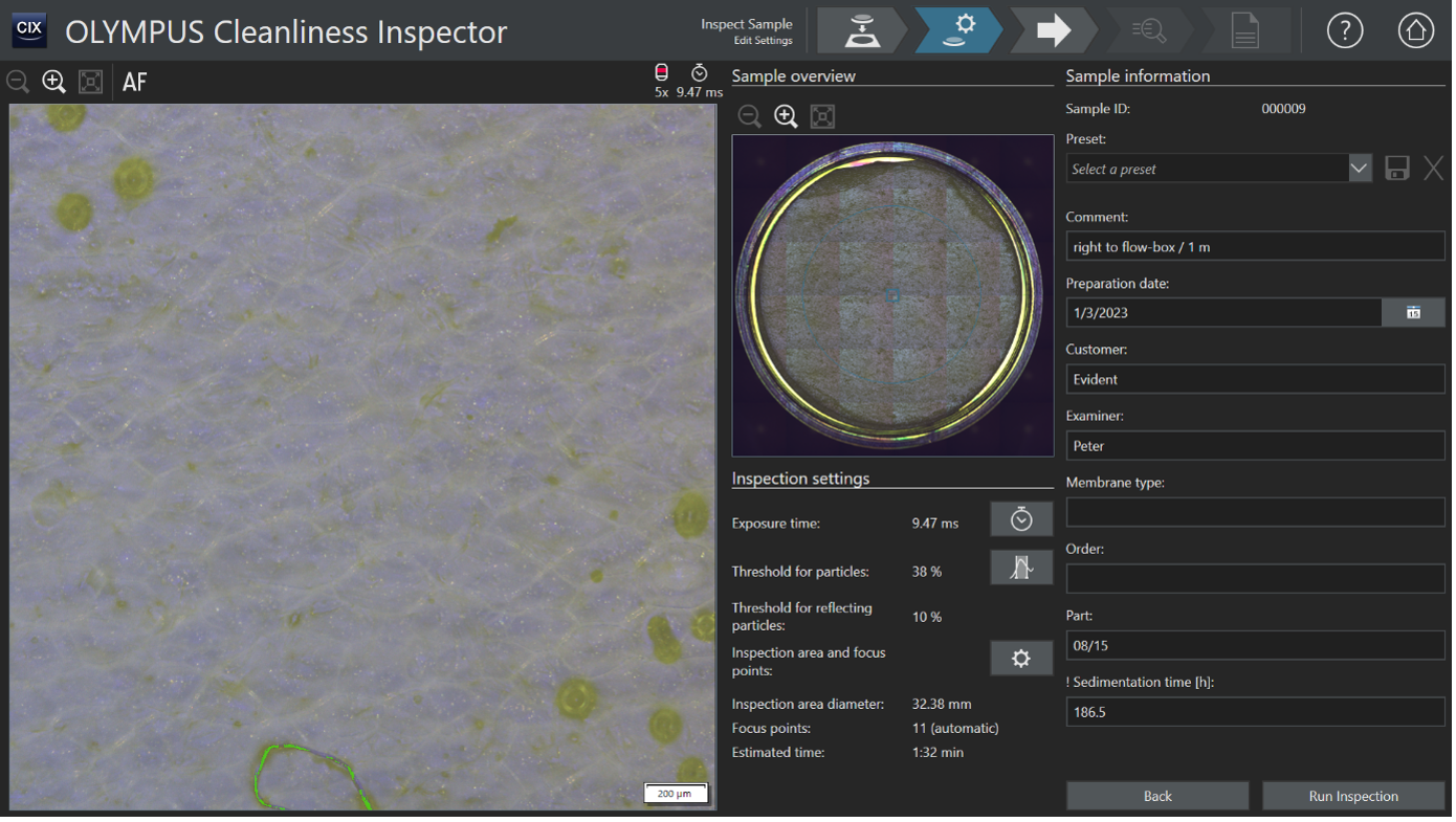

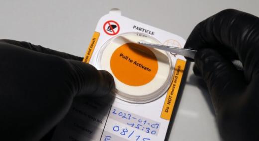

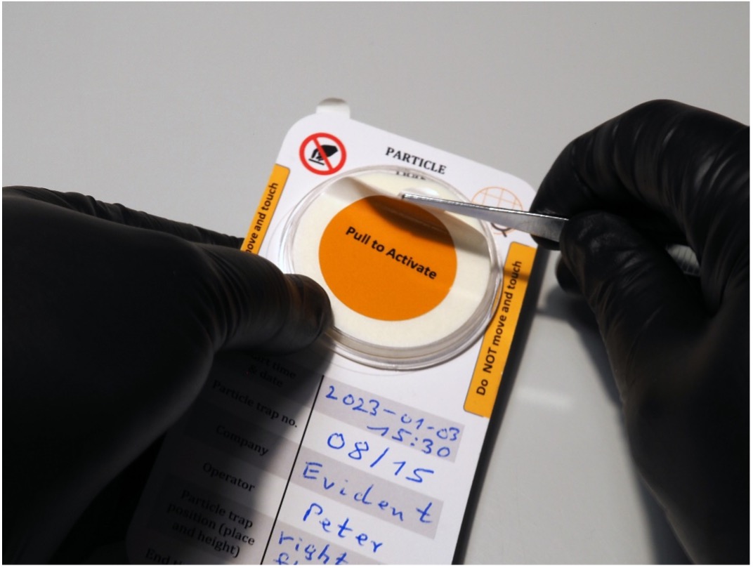

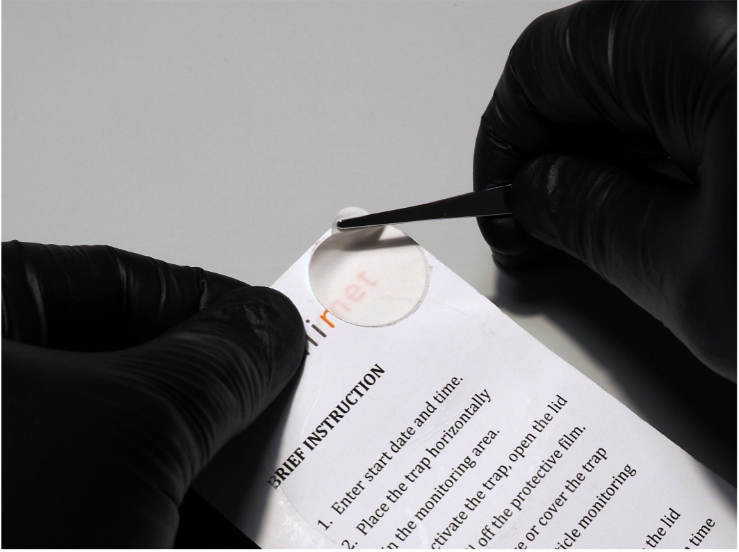

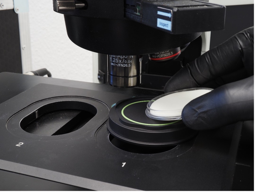

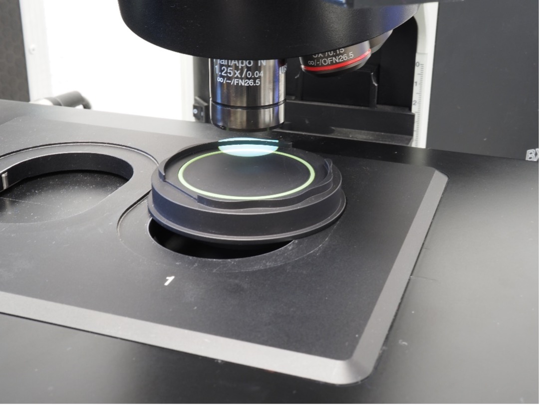

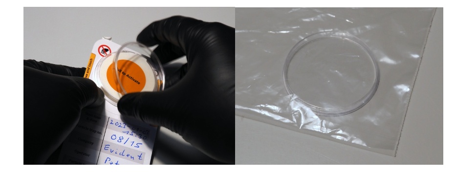

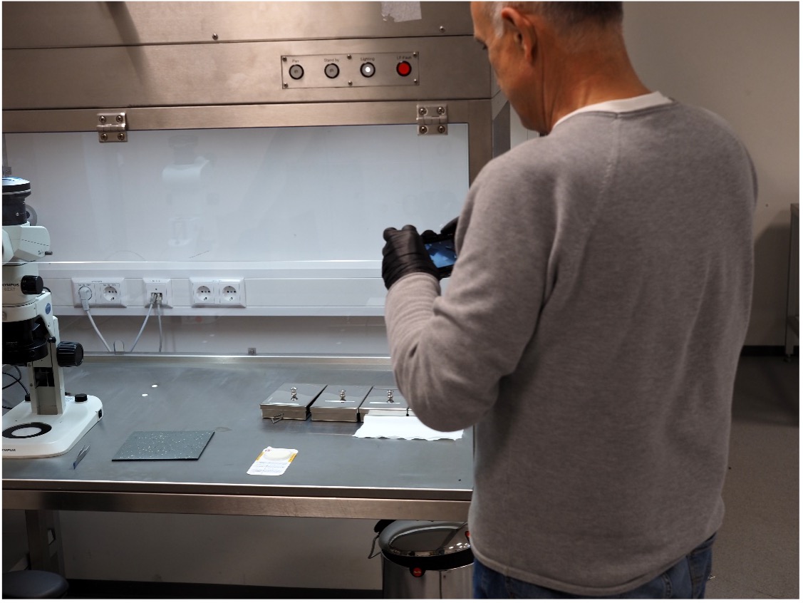

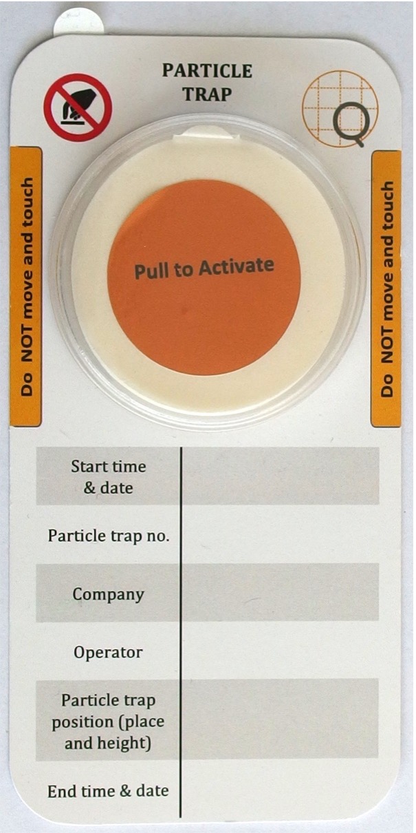

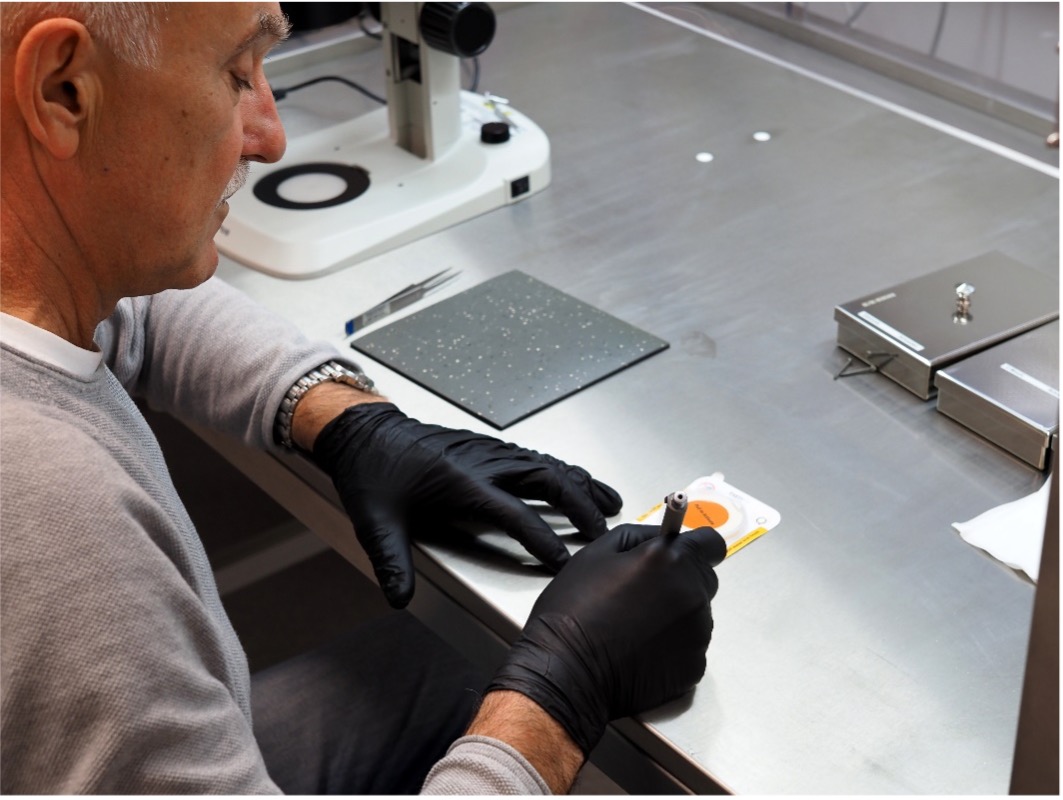

The particle trap method is widely used to monitor the environmental cleanliness of the assembly and logistics processes in production and clean rooms. This practice involves laying out a particle trap, which consists of an adhesive pad about the size of a filter membrane, in places with potential particulate contamination for a defined amount of time to collect air particle sedimentation. The time the particle trap is active is known as the sedimentation time.
