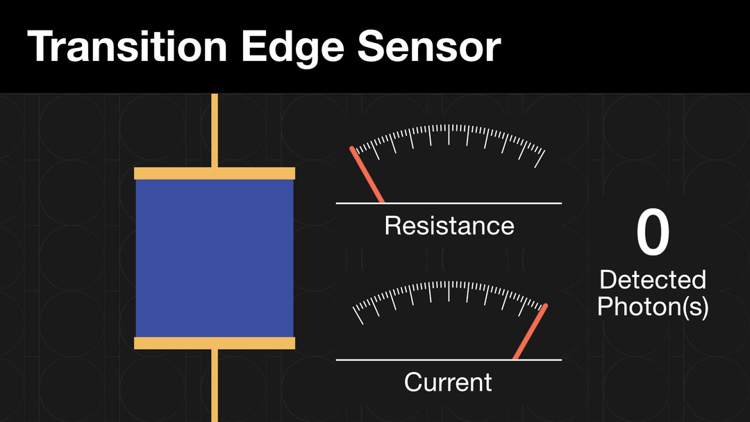

How TES devices work
A transition-edge sensor can detect the number of photons hitting it. The energy deposited by one photon causes a small change in resistance and current. The energy of three photons triggers a larger change. Credit: S. Kelley/NIST
