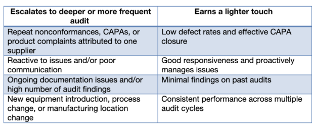

Over time, I shifted to a risk-based approach where how deeply and how often I audited a supplier wasn’t based on a calendar date, but rather on individual supplier risk.
How you determine high vs. low risk is critical, and a key focus for regulators under the new U.S. Food and Drug Administration (FDA) quality management system regulation (QMSR).
Let’s take a closer look at the benefits of risk-based supplier audits and the data that supports them, plus what the FDA and registrars look for when evaluating your supplier program.
