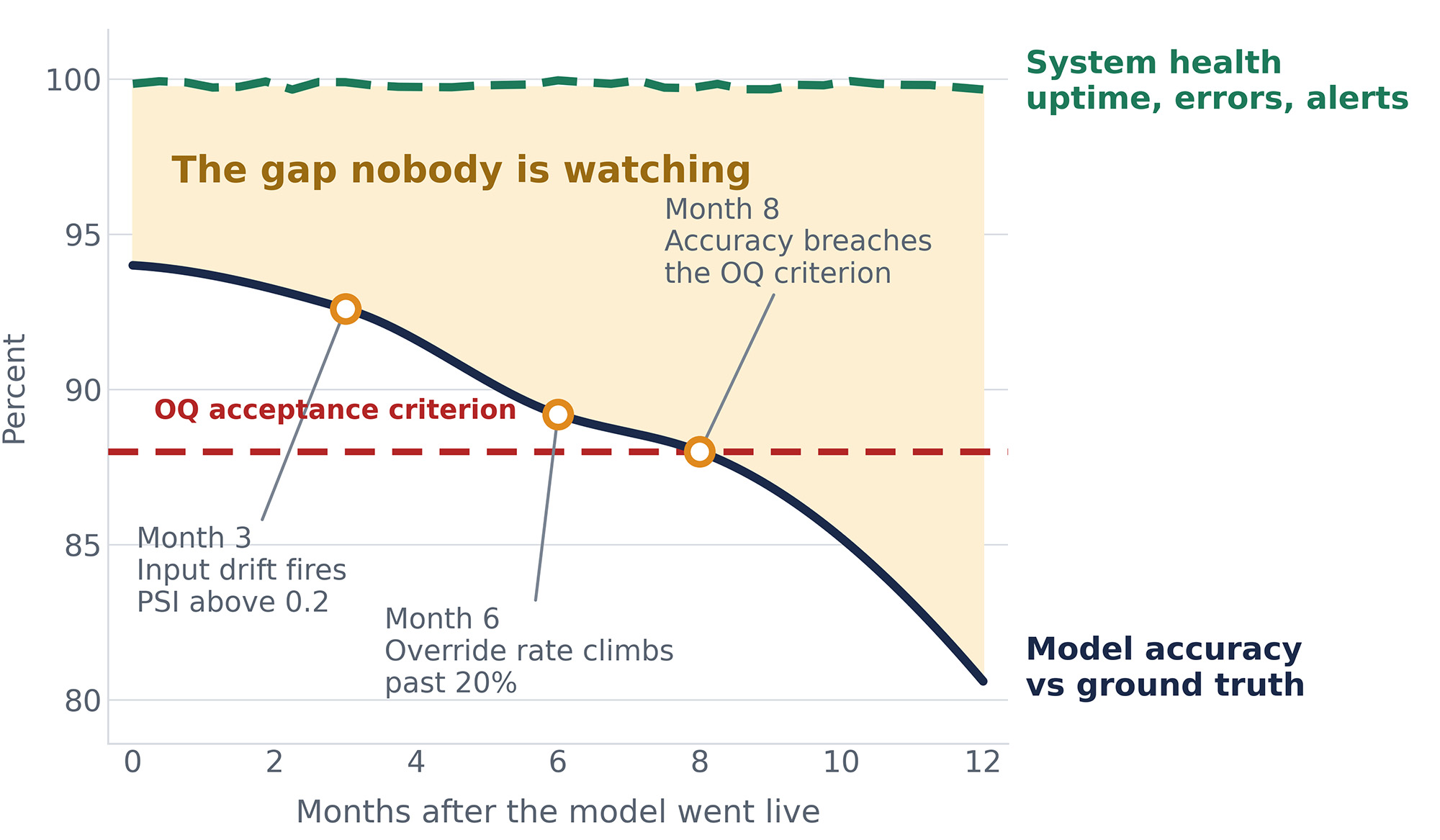

Figure 1 is the shape of the problem. Every system-health metric you monitor stays flat and green for the whole year. Accuracy walks downhill the entire time, until it crosses the acceptance criterion you signed at operational qualification (OQ), the stage where you demonstrate the system performs as specified. The distance between those two lines is the part your dashboard was never built to show you.
Figure 1: The silent gap: Every system-health metric holds flat for 12 months while model accuracy walks downhill, crossing the operational qualification-acceptance criterion at Month 8. Markers show where input drift, override rate, and performance would each have fired. This is illustrative, drawn to show the shape of the failure rather than data from any one site.

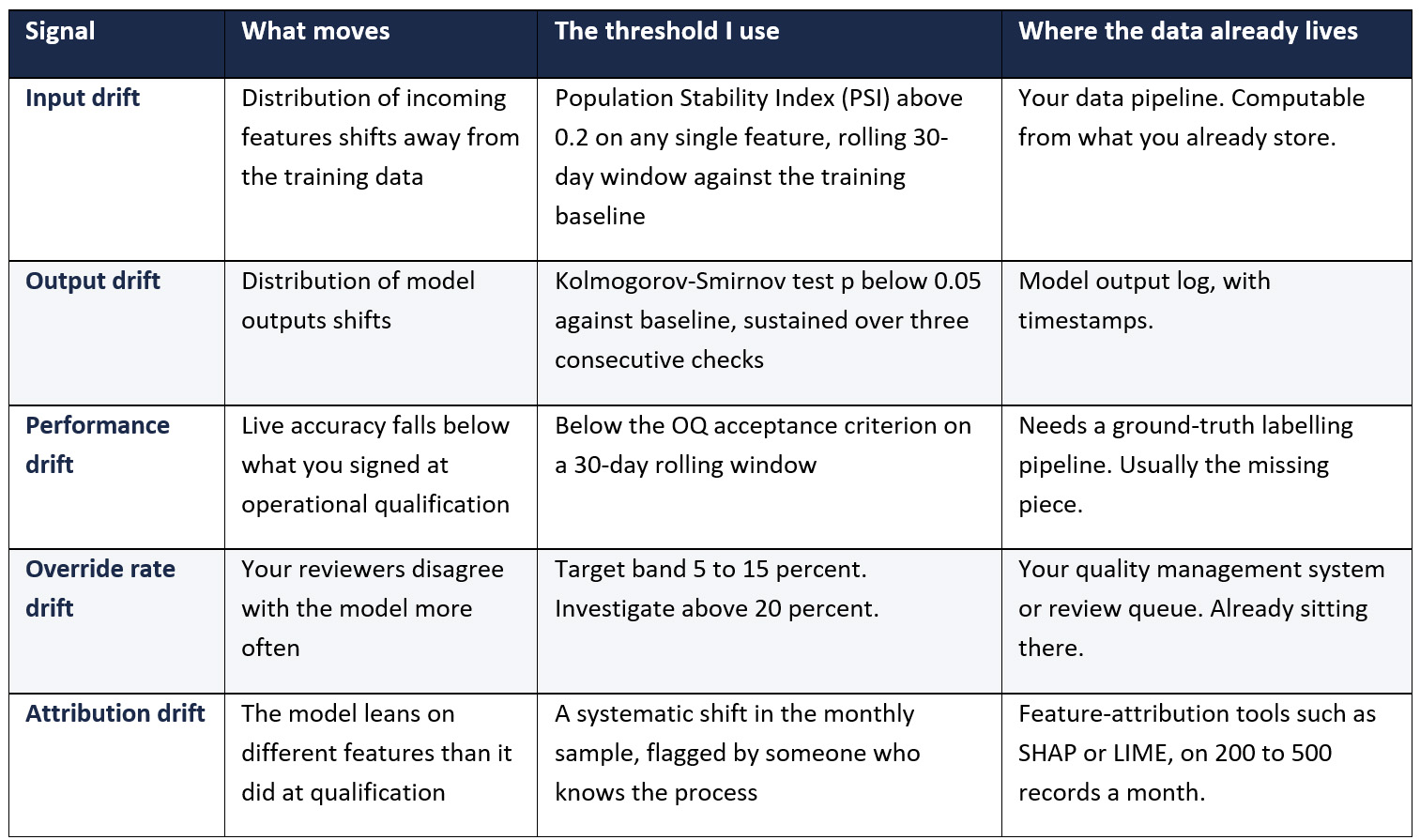

Monitoring is where good intentions turn into arguments about what to measure. Figure 2 sets out the five signals I put in a monitoring plan, the thresholds I use, and where the data usually already sit in your systems.
Before the numbers, here's the honest caveat: These are illustrative starting points, and no regulator has endorsed any of them. The Population Stability Index bands trace to Siddiqi’s work in his book, Credit Risk Scorecards: Developing and Implementing Intelligent Credit Scoring (Wiley, 2015), where 0.10 and 0.25 mark minor and major shifts. They are a rule of thumb rather than a significance test. The override band is a practitioner default I’ve found useful. Calibrate all of it to your own baseline and risk tier, and write down why you chose what you chose. The rationale is the part an auditor reads.
Figure 2: Five drift signals, the thresholds I use, and where the data already live. Thresholds are illustrative starting points, not regulatory limits.
Two of those five signals deserve a comment.
Performance drift is the most direct measure and the hardest to run, because it needs ground truth. If you can’t label outcomes, you can’t measure it. Say so in your monitoring plan rather than leaving the gap silent, and lean harder on the other four.
Override rate is the cheapest signal on the list, and almost nobody tracks it. Your reviewers usually notice a model going wrong months before your statistics do, and the override log is where that knowledge is already sitting. While you’re in there, look for the opposite problem, too. In my experience, a zero override rate across thousands of transactions rarely means the model is perfect. It usually means your reviewers have stopped reading.
