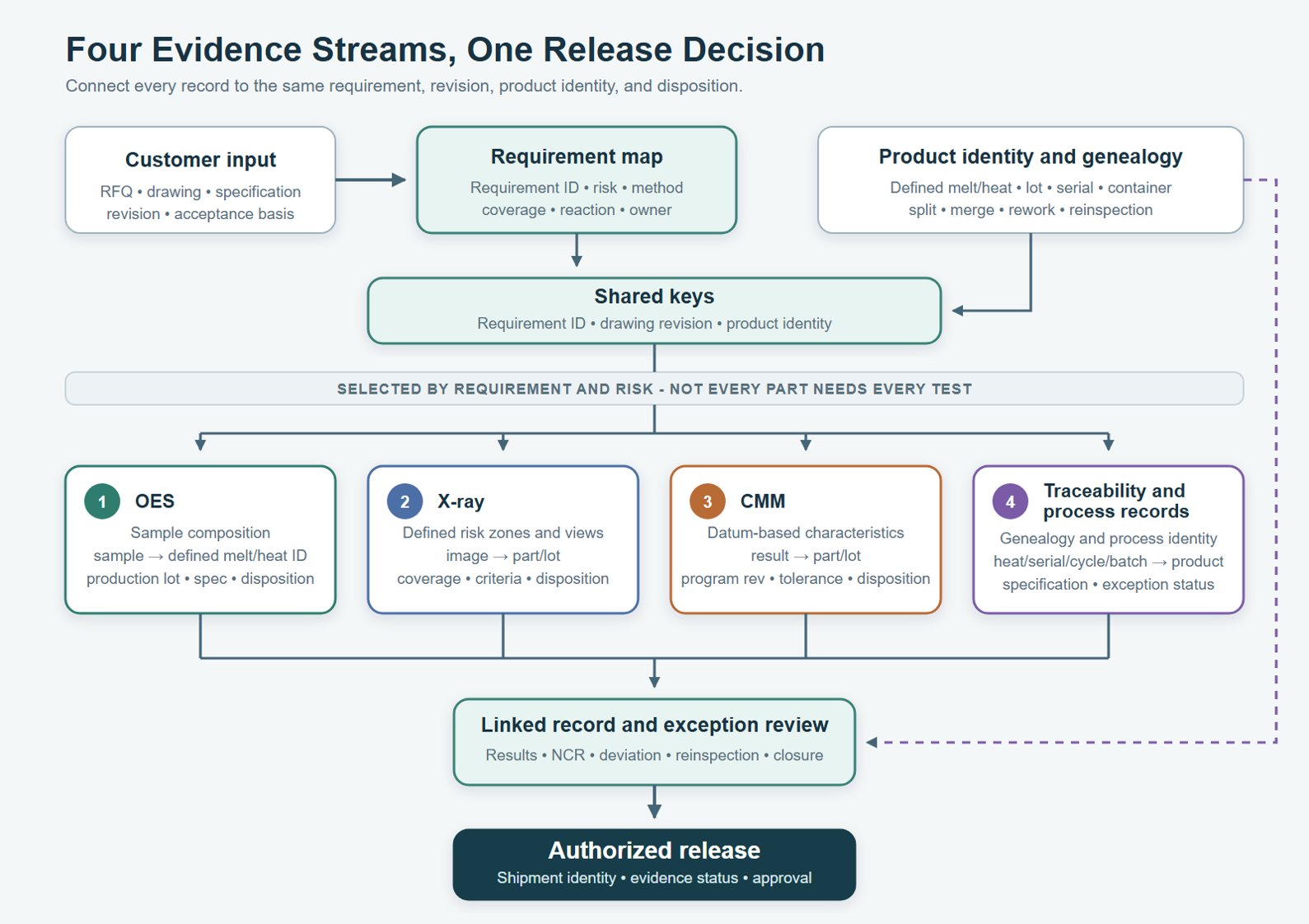

A foundry can produce an impressive inspection package and still leave its customer with an unanswered question: Which records actually supported the decision to ship this part?

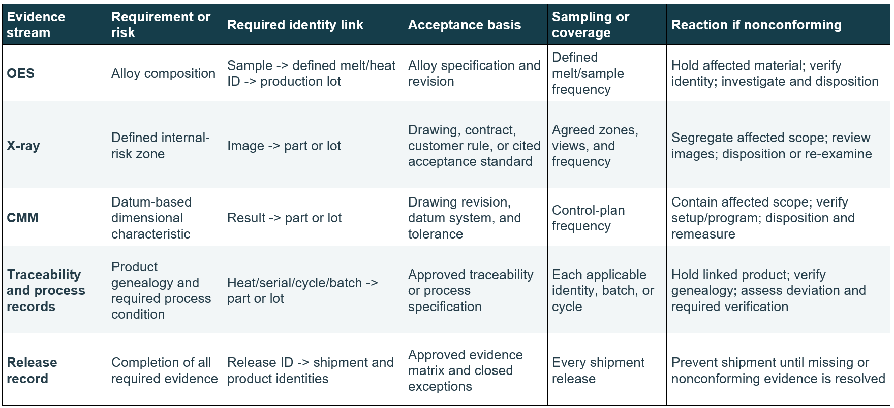

An alloy chemistry report might identify a melt. An X-ray image could show one internal area. A coordinate measuring machine report may verify dimensions. A melt/heat identifier (as defined in the manufacturer’s traceability system) or serial record may follow the product through production. But if those records use different job numbers, drawing revisions, sampling rules, or acceptance criteria, they are a collection of documents, not a defensible quality decision.
The practical challenge is inspecting every characteristic on every part. But what’s important is connecting the evidence that matters to the same requirement, product identity, risk, and release decision. The following method does that without turning every job into a full-inspection exercise.
Start with the decision, not the equipment
Quality planning often begins with a list of available tools. A better starting point is the shipment-release decision. Ask what must be true before this product can ship, and what evidence will show that it’s true.
