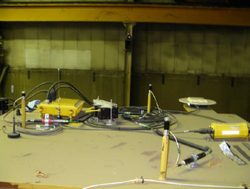

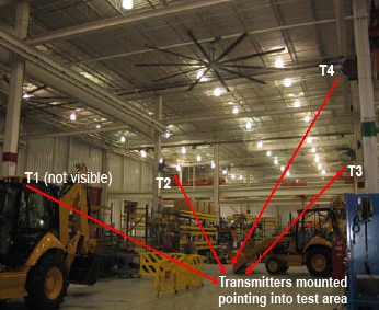

The iGPS consists of infrared transmitters mounted at fixed locations, various sensors— handheld and mountable on the linkage—to measure the location of a point in space, wireless data transmitters to transmit position data from the sensors to a laptop server in real time, and either standard or custom software running on the laptop to capture and process the position information in real time.
Typically, four to six transmitters are used to carry out a sensor calibration for a backhoe loader. Figure 1 shows the mounting of four transmitters pointed down into the test area, where the sensor calibration is to be carried out. A setup for the iGPS is carried out to fix the location and orientation of the transmitters in the test area. The six degrees of freedom (6DOF) of each transmitter have to be determined precisely because this determines the accuracy with which a point can be measured in a given area. Metris has proposed a “bundling algorithm” technique for carrying out the setup. During setup, a number of points are collected using a sensor and receiver in the test area, and the bundling algorithm determines the location of the transmitters relative to the test area, essentially using a “reverse triangulation” technique. The points should be chosen carefully, as this influences the accuracy and precision with which points can be measured.
Figure 1: A typical mounting of the iGPS system while carrying out a calibration of the sensors on the machine. Four transmitters (T1, T2, T3, and T4) are shown pointed into the test area.
After determining the position and orientation of all the transmitters, and thereby setting up the coordinate reference frame in which to carry out the measurements, a scale bar is used to set the coordinate frame scale. The results of the setup are then stored in a configuration file. The metrics give a measure of the quality of the setup. These metrics can be monitored to ensure that the points being collected later are within our accuracy specification. If the metrics exceed a certain level, then a setup can be carried out again to bring it back within specification. After the setup, a known length is measured to verify the scale of the coordinate reference frame. The coordinate frame formed by the iGPS has the x-axis of in the direction of T1 to T2, the z-axis is in the direction of the gravity vector, and the y-axis is then obtained from the cross-product of the unit vectors along the x-axis and the z-axis.

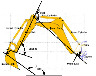

The iGPS was used to calibrate the sensors on an E-series backhoe loader (BHL). This BHL has a number of sensors that are used to locate the orientation of the various links and thereby locate the position of various points on these links with respect to the machine origin. These include:
1. A pitch-roll sensor to measure the orientation of the frame
2. A swing sensor to measure the swing angle of the backhoe linkage arm by measuring the rotation of the swing link with respect to the frame
3. Boom, stick, and bucket in-cylinder sensors to measure the extension of the hydraulic cylinders affecting the orientations of the boom, stick, and bucket links, respectively
4. Estick in-cylinder sensor to measure the extension of the Estick. This is not shown in Figure 2 because it is located inside the stick link housing and is used to extend the reach of the bucket link.
Figure 2: Backhoe linkage arm showing the various links and the corresponding cylinders affecting their orientation
A geometric relationship between cylinder displacements and link angles is used to translate the boom, stick, and bucket cylinder displacements into their corresponding link angles θboom, θstick, and θbucket. These link angles are then used to compute the location of key points like the center tooth tip location on the bucket or the bucket tip using forward kinematics. The accuracy with which the cylinder displacements are measured and the accuracy of the relationship between cylinder displacements and link angles determines the accuracy with which points like the bucket tip can be located with respect to the BHL origin.

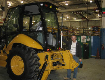

The pitch-roll sensor offsets are determined by measuring a number of points on the frame of the backhoe loader. These points are measured using a handheld vector bar and are with respect to the iGPS frame (global frame in the test area). There are two kinds of vector bars that can be used: the metrology-grade vector bar is smaller and more accurate, whereas the ruggedized tech section vector bar shown in Figure 3 can be used to measure points that are hard to reach or are blocked from the view of at least two transmitters when a metrology-grade vector bar is used.
The location of these points on the frame is known with respect to the BHL origin (same as the frame origin). The BHL origin is located at the center of the rear axle. The location of the BHL origin is also measured with respect to the iGPS frame.
Figure 3: A frame point being measured using a handheld ruggedized tech section vector bar

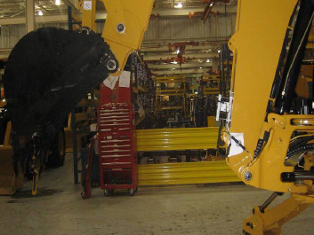

Figure 4: iGPS sensors and wireless data transmitters shown mounted at the Boom link pivot pin and the bucket tip
The swing arm is rotated so that the central plane of the BHL linkage arm containing the center of the boom pivot pin and the bucket tip is parallel to the x-z plane of the iGPS reference system. This represents the swing zero for the BHL linkage arm. The reading of the swing sensor in this position gives the magnitude of the offset in the swing sensor. The arm can be swung to different orientations and an average value of the offset can be calculated by comparing the swing sensor reading to the absolute value of the angle of the centerline of the link arm.

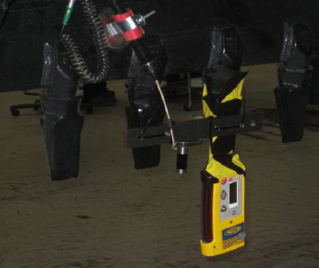

A single-point cylindrical sensor is mounted at the bucket tip, as shown in figure 5. The value measured by the sensor is translated to the BHL frame origin so as to be able to compare it to the bucket tip value calculated within the on-machine control module using forward kinematics. The bucket tip is moved to various locations in space and the static accuracy of the bucket tip is calculated at each location by measuring the difference between the calculated value and the measured value. If the bucket tip errors are outside the desired accuracy specification, then the calibration is repeated.
Figure 5: A cylindrical iGPS sensor is mounted between the third and fourth teeth of the bucket link. The center tooth tip or the bucket tip is at this location. The yellow receiver suspended by a tape is not part of the setup.

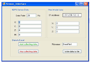

Figure 6: Interface developed to collect data in real time
A cylindrical sensor is mounted at the bucket tip, as shown in figure 5. An interface shown in figure 6 was designed to capture the position of the sensor position in real time, along with the position of the bucket tip calculated by the onboard control module on the BHL. To compare the computed bucket tip value to that obtained from the iGPS sensor, it is critical that the data be collected at the same rate. A data rate of 25 Hertz was found to work well for a normal digging motion.

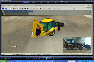

Integration with 3-D display software and augmented reality

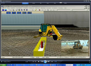

The real-time position of the BHL as well as the location of the link arm is sent from the BHL control software to the 3-D display software in real time. This information is used to update the BHL image in the 3-D display software continuously. In figure 8, a screen shot of the 3-D display software shows the BHL digging a trench. The position of the BHL in the indoor arena is known and corresponds really well to the actual position in the arena as shown by the actual video.
The 3-D display software can also be simultaneously running on the onboard display computer. The image captured in figure 8 was captured when the 3-D display software was running on a remote computer. The BHL location and the link position information were transmitted wirelessly to the remote computer.
Figure 8: The BHL is shown digging a trench in the 3-D display software. The corresponding shot from a video camcorder is embedded in the right corner to show the correlation to the real world.
A trench-digging operation is initially carried out in a stationary position of the BHL to verify that the data from the iGPS sensors and the motion of the image in the display software was in accordance with the motion of the BHL in the real world. A slight delay was observed in updating the image in the display software, which could be because of the refresh rate in the display software. The position from the iGPS sensors was being updated at close to 25 Hz, but there were some delays associated with the information being sent from the display software to the control software, where the location of the BHL was computed and then sent wirelessly across to the remote computer on which the 3-D display software was running. The delay could have also been because the BHL image had a high polygon count (a factor affecting the refresh rate of the image) and this could have slowed down the update rate.
Figure 9: Screen shot of the 3-D display software screen showing the BHL driving around in the indoor arena. The corresponding shot from a video camcorder is embedded in the right corner to show the correlation to the real world.
This was clearly evident when the BHL was driven around in the indoor arena. Even though the BHL frame location was being updated at a fairly fast rate, there was a delay in the image updating in the 3-D display software. A screen shot of the BHL driving around in the indoor arena, along with the corresponding image captured with a video camcorder, is shown in figure 9. The picture may look slightly different because the door to the indoor arena appears closed in the 3-D display software. Also, the location of the camera in the display software is different from the location of the physical video camcorder. A closer inspection will reveal that the two images match up well.
