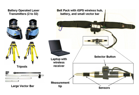

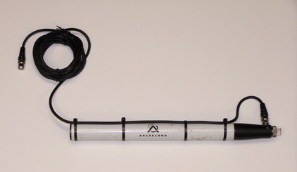

SURVICE selected the use, enhancement, and extension of the Metris iGPS large-volume metrology equipment (as seen in figure 1) as part of the solution. The iGPS system is a lightweight and portable laser-based metrology device that is ideally suited for the requirements of the research effort. By having Metris as part of the team, SURVICE has been able to develop customized hardware adaptations to the existing commercial metrology equipment offerings.
Figure 1:  Metris iGPS system

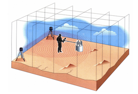

The iGPS system consists of two or more laser transmitters that are set up on tripods or affixed to walls in a shop or work area. The transmitters can run on standard electric power or internal/rechargeable batteries. The transmitters flood the vicinity with encoded laser light, which is received by sensors on a “vector bar,” as seen in figures 1 and 2.  The sensor data are fed to a battery-powered belt pack and sent wirelessly to a laptop (or desktop PC), where the raw sensor data from multiple laser transmitters are triangulated and converted into spatial coordinates. The precise location of the measurement tip is updated continuously as the vector bar is moved around the subject.
Figure 2: iGPS setup
The iGPS system allows multiple operators to roam around a given area and collect 3-D data. The system has a range of approximately 50 meters and can collect spatial data within 100–400 μm. The iGPS system provides a constant stream of xyz coordinate data, and the user clicks a button on the vector bar (as seen in figure 1) to store the current/selected location. SURVICE proposed the integration of ultrasonic sensor technology to the standard vector bar and allowed a second data stream to be fed, collected, and stored with the corresponding spatial information. This new configuration allows the operator to seamlessly collect composite delamination and location information quickly and easily.

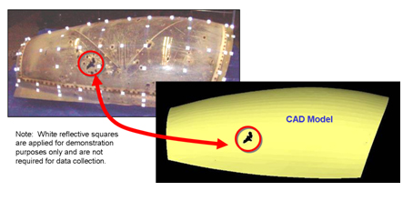

Under separate but related research grants as well as internal research and development activities, SURVICE has developed custom 3-D software solutions that integrate with the iGPS system, which streamline data acquisition and subsequent analysis, including superimposing the damage onto existing CAD models, as seen in figure 3.
Figure 3: Superposition of damage onto CAD model

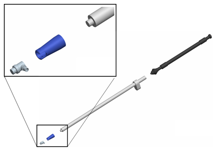

The first effort under the research grant was to integrate a selected ultrasonic sensor into the iGPS hardware configuration. Figure 5 shows design drawings developed to house the ultrasonic sensor. Unlike laboratory systems that use dual sensors in a pulse-receive mode (with one sensor transmitting on one side of the test article and another sensor receiving the signal on the opposite side of the test article), the proposed system uses a single sensor in “pulse-echo” mode, requiring the same sensor to perform both duties of signal generator as well as signal receiver, and do so from the same side of the test article.
Figure 5: Vector bar modifications

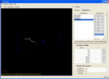

Next, the core of the existing Archer graphics package was modified and enhanced to process multiple data streams; one from the iGPS hardware and one from the ultrasonic sensor (and its associated hardware). This new software application, dubbed Sherlock (for its inspection capabilities), is seen in figure 7. In addition to storing ultrasonic measurement information as metadata to 3-D data points, the software uses heuristics about the data being collected to automatically assign damage into associated groups (based upon aspects such as point proximity, time, etc.), allowing data to be collected with minimal user interaction with the computer.
Figure 7: Sherlock software prototype

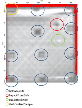

The University of Delaware (UD) Center for Composite Materials (CCM) fabricated a composite laminate for testing of the ultrasonic sensor and pulse-echo hardware.  Induced voids were added to the panel by using azodicarbonamide (a blowing agent) and Teflon inserts placed within the layers of the composite to simulate debonding. Finally, the panel was impacted with a steel ball at multiple locations. The majority of these defects were not visually observable. Figure 8 shows the test panel used for the tests with the fabricated defects at various locations.
Figure 8: Test panel scan

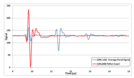

The panel was evaluated using the prototype system. The probe allows introduction of the ultrasonic pulse into the sample using a coupling agent. In addition, a polymer-based coupler was used to extend/delay the signal in a range (> 9 µs) where the transducer ringing is negligible. Figure 9 shows two specific locations that were evaluated, including one area containing a Teflon insert where a debonding reflection would be expected, and in another area (no voids, Teflon, or damage) where an average signal is expected. This result is similar to the dual-sensor laboratory-based baseline signals at the same locations.  At the defect location, there is virtually a complete reflection at the surface with almost no reflection afterward, and the average panel signal shows the back surface return signal after approximately 1.5 µs and subsequent reflections (as expected).
Figure 9: Ultrasonic scan comparisons
This test verified the feasibility of the prototype system, clearly being able to distinguish between normal and delaminated (or defective) composite material in a portable, pulse-echo ultrasonic sensor configuration integrated into the iGPS hardware.
