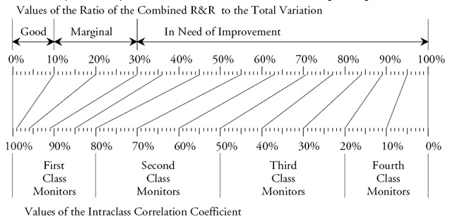

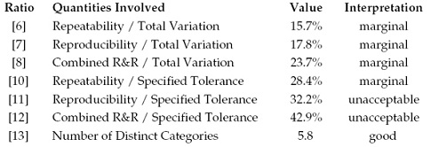

Measurement error is ubiquitous. As a result, over the past 250 years, different areas of science and engineering have come up with many different ways to deal with the problem. One approach to the problem of measurement error was developed during the 1960s within General Motors. Throughout the years it was modified and revised, until in 1989, it was turned over to the Automotive Industry Action Group (AIAG). Since that time, the AIAG gauge repeatability and reproducibility (R&R) study has been promoted throughout many different industries. Unfortunately, the original procedure contained some fundamental problems that have not been corrected over the years. This column will address these historic problems and suggest solutions.
The AIAG gauge R&R study
The gauge R&R study starts out with a sound strategy for collecting data. A simple fully-crossed experiment is performed where two or more operators measure each of three to 10 parts two or three times apiece. To have an example, we will use the data shown in figure 1 where three operators measure each of five parts two times apiece.

Michael Petrovich is right about the origin and use of d2*. The inconsistent use of d2 and d2* is part of the AIAG study. I did not recommend these formulas, but merely presented the formulas used by AIAG. In my EMP book I present a table of formulas for estimators of various quantities which lists 12 alternatives for the three basic variances involved. However, when using the adjustment terms shown for repeatability, we are estimating a variance, and so d2* is appropriate. We could also take exception with the way the AIAG study uses adjustment terms for Repeatability and yet fails to use adjustment terms for the product variation (where it inappropriately uses d2*).

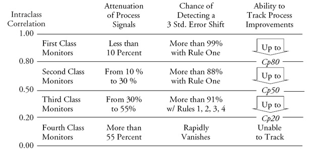

On the second point, I will refrain from agreeing that the intraclass correlation is "bogus." It is the correlation between two measurements of the same item. It is theoretically sound, and it provides a way to characterize the relative utility of a measurement system for a given application. However, I did not address the issue of how the parts are selected. In my EMP book I discuss and illustrate systematic samples, grab samples, and other types of sampling with EMP Studies. The structure of the data in an R&R study will result in a decent estimate of measurement error, but it will give you a soft estimate of the product variation (9 d.f. or less). This means that there will be a lot of uncertainty in any of the ratios computed. In my book I also discuss how to solve the problem of a lack of degrees of freedom for the product variation estimate.
I am aware of the differences in fixed and random effect analysis. I deal with these differences in my EMP book where I show how to detect and estimate operator biases. However, the AIAG gauge R&R study simply assumes that the operators are different and that they are a random effect. Since I had already shown the R&R study to be inappropriate in so many other ways, I did not go on to address this issue in this paper in the interest of simplicity.

The method Dr. Wheeler is describing is the "Xbar-R Method" in Gage R&R (Crossed) in Minitab and the "honest" ratios are presented as well as the AIAG ratios. The "honest" ones are in the %Contribution column presented first, and the AIAG ratios are presented as %Study Var in the next table.
For what it's worth, I believe most practitioners with stat software are currently using the ANOVA method and not Xbar-R, but the concepts of additivity among %Contribution as compared to %Study Var hold true just the same. I believe the only attractive propoerty of %Study Var is that it is in the original units of the data and at least in that dimension has an easier interpretation, but without a firm understanding of the underlying formulas and concepts the correct interpretation of each is likely lost.
