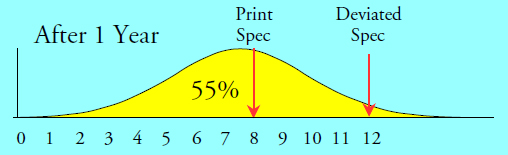

One client had a problem with the conformity of a high-volume product. Historically, 50 percent of their production had failed to meet the blueprint specification of less than 8 mils. Since 50-percent conforming would not allow them to ship enough product, the customer had agreed to a “deviated specification” of less than 12 mils. This allowed about 90 to 95 percent of the product to be shipped. The manufacturer and customer had operated with this deviated specification for several years, and they had found that the product worked satisfactorily in the field.
