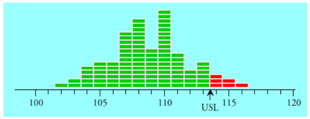

One of the most common questions about any production process is, “What is the fraction nonconforming?” Many different approaches have been used to answer this question. This article will compare the two most widely used approaches and define the essential uncertainty inherent for all of these approaches.
In order to make the following discussion concrete we will need an example. Here we shall use a collection of 100 observations obtained from a predictable process. These values are the lengths of pieces of wire with a spade connector on each end. These wires were used to connect the horn button on a steering wheel assembly. For purposes of our discussion let us assume the upper specification for this length is 113 mm.
Figure 1: Histogram of 100 wire lengths

The Agresti-Coull confidence interval uses the Wilson point estimate. The Wilson point estimate adds the z-score for the alpha level to both the number of successes and the number of failures.  So, for a 95% interval we add 1.96 successes and 1.96 failures to the counts.  Since we are dealing with counts we typiclaly round these off to 2 successes and 2 failures.  For a 90% Agresti Coull interval the Wilson point estimate would add 1.65 failures and 1.65 successes, etc.  The Wilson point estimtes were used in yet another formula for a confidence interval, done in the first half of the 20th Century.  In 2003 Agresti and Coull did an extensive survey of all the ways of obtaining a confidence interval for a proportion, analyzed how they worked in practice, and came up with their synthesis that is now the preferred method for such a confidence interval.
