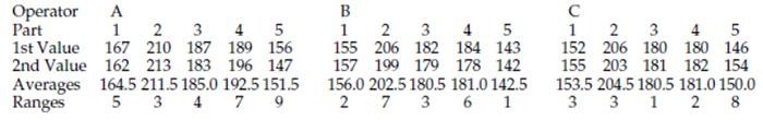

The AIAG Gauge R&R Study starts out with a sound strategy for collecting data. A simple fully crossed experiment is performed where two or more operators measure each of three to 10 parts two or three times apiece. To have an example to use we shall use the data shown in figure 1 where three operators measure each of five parts two times apiece.
