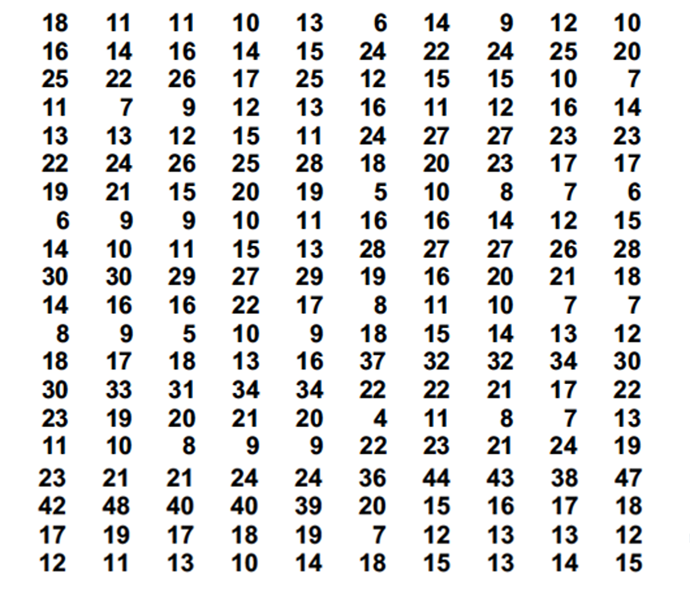

The first approach is description. This uses the descriptive statistics and histograms taught in introductory classes in statistics. For our example, we’ll use the 200 observations listed in Figure 1.
Figure 1: 200 original observations X
The basic descriptive technique is to collect all the data into a histogram and compute the basic properties of the data set as a whole. The minimum value is 4, the median is 16, and the maximum value is 48. The average for the histogram in Figure 2 is 18.24, and the standard deviation statistic is 8.77.

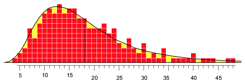

Some data analysts seek to generalize observational data by finding a probability model that fits the histogram. Since our histogram is skewed, we’ll want to use a skewed probability model to characterize the process. And a family of skewed distributions preferred by many statisticians is the family of lognormal distributions. If these data might be reasonably modeled by a lognormal distribution, we can use the descriptive statistics from the histogram to estimate the two parameters for the lognormal model.
The scale parameter, alpha, may be estimated by the median of the original data. Here the median is 16, and so we estimate alpha = 16.
The shape parameter, beta, may be estimated according to the formula:
So we divide the average for the histogram by the median for the histogram, find the natural logarithm, multiply by 2, and take the square root to find an estimate of beta. For our data, this operation gives an estimate of beta of 0.511. So here we might use a lognormal (16, 0.5) model. This model is plotted on top of the histogram in Figure 3.
Figure 3: Original observations X with lognormal (16, 0.5) model
The advantage of having a lognormal model for our data is that we can compute probabilities using a standard normal distribution. Specifically, the probability that the lognormal variable X is less than some value X = x is the same as the probability that a standard normal variable, Z, is less than the value Z = z where:
So that
For example, using the upper watershed specification limit of 30.5, we might estimate that this process is likely to produce 9.85% nonconforming:
In the same way, we could compute a customized upper “control” limit for this process that would cover 99.7% of these observed values:
So we might predict that virtually all of the future values should fall between zero and 63.3 unless something changes in this process.

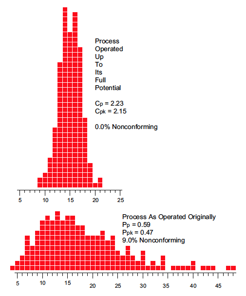

So, after characterizing these data, what do you tell the boss? Find what’s causing the oscillation, and we can run this process so that it will produce 100% conforming product. No sorting needed. No prayers required. Just make it and ship it.
Figure 5 shows what this manufacturer was able to accomplish by identifying and controlling the previously unknown cause of the process oscillations.
Figure 5: Predictable operation vs. the original data
