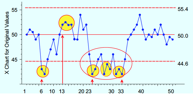

The data in Figure 1 are the maximum measured diameters for a given camshaft bearing surface on 50 consecutively produced parts. The unit of measurement is 0.0001 in., and each value is the amount by which the diameter exceeds a reference value of 1.3700 in. The time order for these values is given by reading down each column, beginning with the column on the left.
Figure 1: Camshaft-bearing diameters, X
