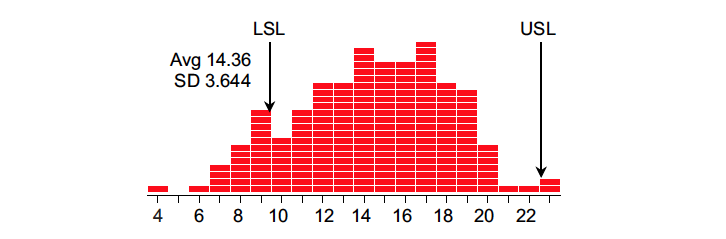

A new product was being made on an existing production line that had no temperature control system for the bath. When the initial production run had 25% nonconforming product, the project team decided to see if they could improve things by controlling the bath temperature.
Figure 1: Process outcomes during experiment
