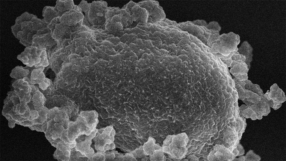

A scanning electron microscope captures the moments before lithium oxide (larger, middle particle) sublimates and mixes with the nickel-rich material surrounding it.
