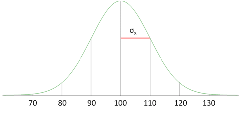

Last month I wrote about how the random sampling distribution (RSD) of various sample statistics are the basis for pretty much everything in statistics. If you understand RSDs, you understand a lot about why we do what we do in hypothesis testing, inferential statistics, and estimation of confidence intervals. Understanding RSDs gives you a huge advantage as you seek to use data in business, so let's take a closer look.
First, a brief refresher from last month. We have the big honkin' distribution (BHD), which is the distribution of the entire population of interest as shown in figure 1:
Figure 1: Big honkin distribution (BHD) of the entire population of interest

Product distribution
Your first assumption is meaningless. We never know the product distribution. A vast amout of data is required to even roughly estimate it and the process will change during any attempt to estimate it.

Meaningless...or Masterful?
Hi again ADB, and thanks for reading.
This is what is known technically as a "simplification for instructional purposes." :) No actual products were harmed during the writing of this article, which was intended as an introduction to RSDs and why they are so important. So if my pretend process happens to be normally distributed, so it is.
However, to your point. Real processes do tend to have distributions of some sort, at least at the level to where they are, in Box's words, useful models. Thankfully, the physical limitations of the universe mean that we don't often find processes that are totally random walks. There is often a confluence of influences that result in knowable distributions: the "memorylessness" of the exponential and its relation to the Poisson, the binomial distribution of a Bernoulli process, the many small sources of random variability that result in a normal distribution, all of these can be useful models for real process behavior. As long as you don't forget that they are models. But in business, we often have to make assumptions in order to make decisions - otherwise we end up in analysis paralysis never making a decision because nothing is *exactly* normally distributed, or we make decisions based on our gut in the absence of any data or analysis. (We do need to test the validity of our assumptions, though.)
A common error made about hypothesis testing is that we are saying a process is *really* distributed as something mathematical. We are only using useful models (hopefully with some theoretical basis in reality) to help reduce the error rate of our decisions and give us a repeatable way of making decisions, rather than relying on "I believe it must be so" reasoning. When I teach statistics, I test, in order, "shape, spread, location." If the shape is reasonably approximated by some known distribution, or can be transformed as such, then the probability of us making a bad decision due to that assumption is low. If it cannot, then maybe we can use some other non-parametric test to still help with our decision-making. If I took all the decisions I have made using statistics and knew which ones were "right" and "wrong" I would grant you that the number wrong would be some amount higher than the declared alpha error level, due to differences in assumed distributions, unknown systematic errors and threats to external validity, uncontrolled factors, etc. But not much higher, and much more correct than if managers used their gut to make their decisions for them.
Of course, if we have a process where we have control charts on all critical process variables, and we react as they go out of control, then it is pretty likely that we do see a nice, model-able, useful distribution of some sort. And a cool thing about RSDs of means is that, regardless of the distribution of the individuals and given a large enough sample size, the RSD tends to be normally distributed. So we are probably not far off when we make decisions based on a sample with a t-test, for example.
When we get stuck modeling a process empirically (like using the Johnson family to fit a distribution to sample statistics) then things do get nasty, and that is my least-preferred way to make decisions. But even so, sometimes decisions must be made, and at least I have a repeatable, gut-feel-independent process I followed in making them. I just need to keep in mind that that model is highly provisional and subject to rather large errors.
