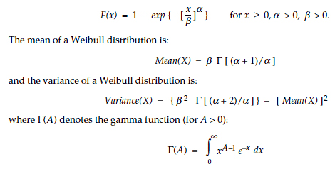

Weibull distributions are widely used in reliability theory and are generally found in most statistical software packages. This makes these distributions easy to use without having to work with complicated equations. The following equations are included here in the interest of clarity. The Weibull distributions depend upon two parameters: alpha, α, and beta, β. The cumulative distribution function for the Weibull family has the form:
