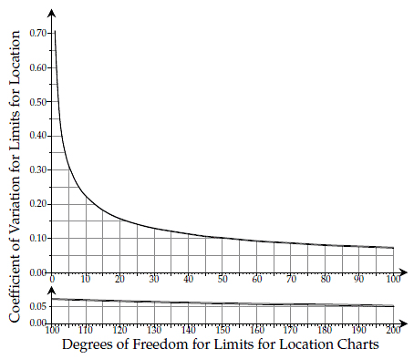

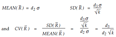

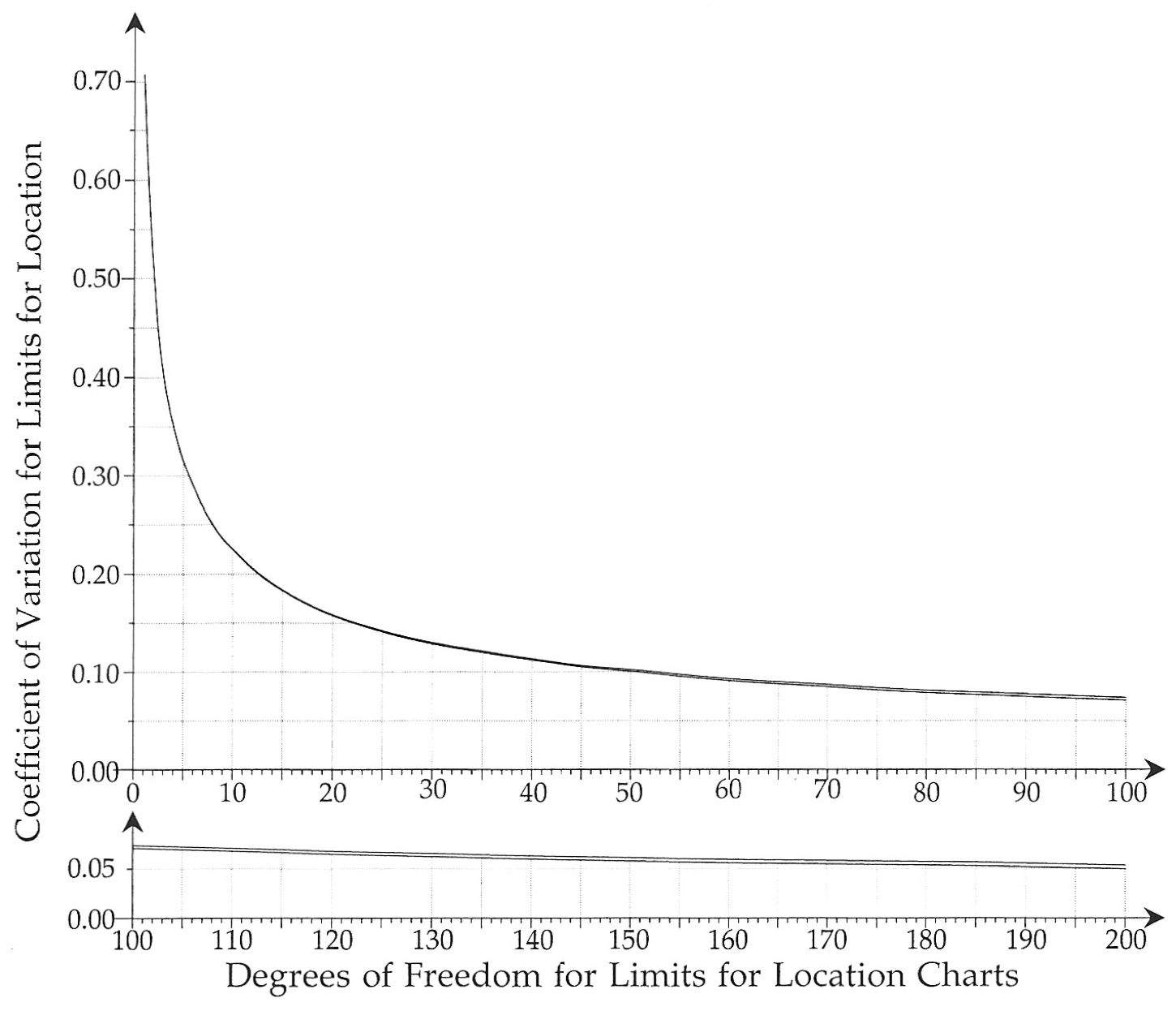

Before we can discuss the computation of limits for non-normal probability models, we will need to have a way to quantify the uncertainty in the computed limits. The curve that does this is given in figure 1.
Figure 1: Uncertainty and degrees of freedom for process behavior chart limits. Click here for larger image.
