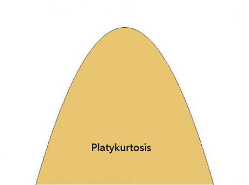

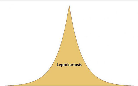

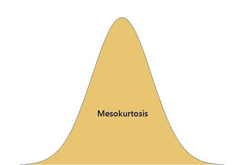

Frequently, you’ll see kurtosis defined as how sharply “peaked” the data are. The three main types of kurtosis are shown below.
Lepto means “thin” or “slender” in Greek. In leptokurtosis, the kurtosis value is high.
Platy means “broad” or “flat”—as in duck-billed platypus. In platykurtosis, the kurtosis value is low.
Meso means “middle” or “between.” The normal distribution is mesokurtic.
Mesokurtosis can be defined with a value of 0 (called its "excess" kurtosis value). Using that benchmark, leptokurtic distributions have positive kurtosis values and platykurtic distributions have negative kurtosis values.

Also, as your comment implies, the severity of leptokurtosis is important as well. You suggest a kurtosis measure greater than 4 might be problematic, even in Dr. Wheeler’ view. The first illustration in my post is based on a laplace distribution with a kurtosis value of 5.6 (assuming the kurtosis measure that defines a normal distribution with a kurtosis of 3). The second “liposuction” illustration of leptokurtosis is based on a t distribution with a kurtosis value of 8.6—well above 4 in both cases!. (Of course such benchmarks are only of value in a very rough sense anyway and shouldn’t be taken too literally. Like most statistical estimates, they're influenced by sample size, variance, etc. Nevertheless some applications do have a recommended "safe" range of kurtosis values..)
