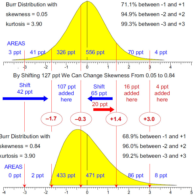

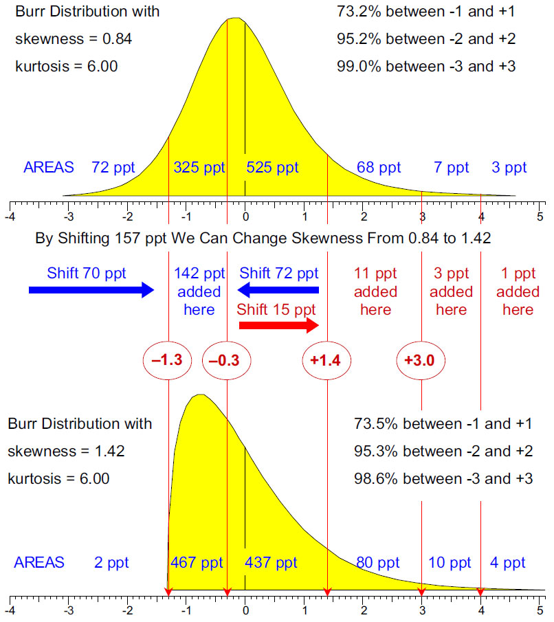

The computation for skewness does not fully describe everything that happens as a distribution becomes more skewed. Here we shall use some examples to visualize just what skewness does—and does not—involve.

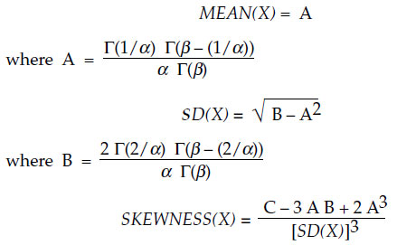

The mean for a probability model describes the balance point. The standard deviation describes the dispersion about the mean. Yet a simple description of skewness is elusive. Depending on which book you read, skewness may be described as having something to do with the relative size of the two tails, or with the weight of the heavier tail of a probability model.
