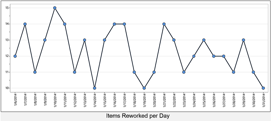

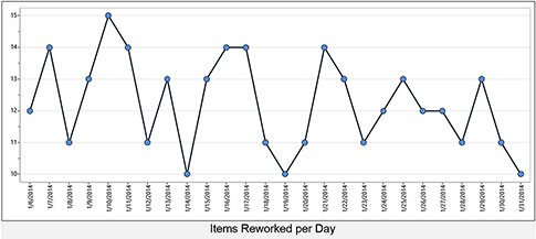

Consider the following data series:
Click here for larger image.
When presented in this form, what kind of predictions can you make about the response variable? You might note the scale of the chart and make this prediction:
Most of the data will be between 10 and 15.
