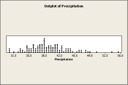

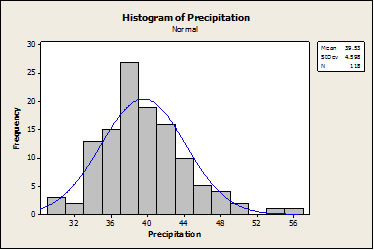

The data were then entered into a dot plot, which uses dots in place of bars and allows the visualization of the individual data points. The dot plot depicted in figure 2 shows the concentration of results around 38 in., with a few potential outliers at almost 56 in. The same data can be seen in the histogram in figure 3.

Like the stem-and-leaf diagram and dot plot, the histogram shows the spread of the data with a concentration around 38 in. and several outliers on the high side. A quality engineer could quickly observe the spread of the data by using a stem-and-leaf diagram, dot plot, or histogram.

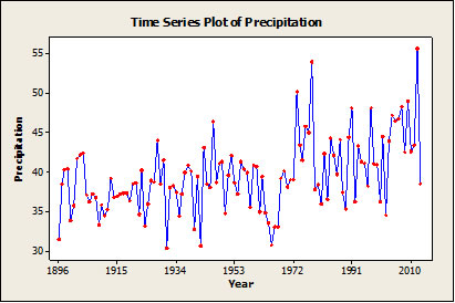

In all three of these graphical displays, the skew of the data is quickly observable, but these may not present a complete picture. All we can see is the range and distribution of rainfall over time. Interesting, but not very useful. In order to gain more insight, we need to enter the data into a time series plot to look for potential patterns.
The time series plot of precipitation in figure 4 shows an increase in precipitation over time. The average of any given year varies; therefore, some years during the 1990s had less rain than years during the 1890s, but a trend appears to be present and is even more noticeable when the data are separated into groupings of 19 years each and then entered into the box plot in figure 5.

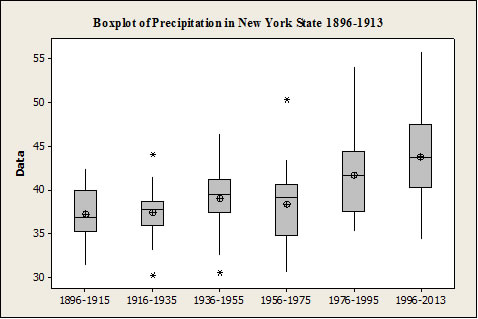

Box plots, also known also box-and-whisker diagrams, are a simple yet effective part of EDA. They can easily be constructed by hand or by using a statistical software program. The box in the box plot contains the 25th and 75th percentiles and uses a horizontal line within the box to identify the median of the data set. The average of the data set is identified by a plus sign with a circle around it. The lines, or whiskers, identify the rest of the data set, except when outliers are present. Outliers, which are numbers that deviate greatly from the rest of the data set, are identified by asterisks.
The box blot in figure 5 shows that the range of the data has increased during the past four decades as compared to earlier data. It would also appear that New York state has gotten wetter during the past 40 years. (The final grouping is an exception; however, only a few years’ worth of data was used for this grouping.)

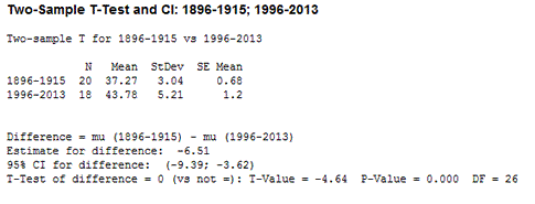

The same EDA concepts could have been used by a quality engineer analyzing the dimensions of a manufactured product. For example, a quality engineer might collect data on the diameter of a machined cylinder during a root cause analysis. The data could then be subjected to EDA to gain a basic understanding of what’s happening during the processes, and this could then be subjected to methods of a more quantitative nature. Figure 6 depicts a two-sample t-test of the New York state precipitation data. The null hypothesis looked at the amount of precipitation between 1896 and 1905 and is equal to the precipitation between 1996 and 2013. The alternative hypothesis looked at whether there is a difference between the two time periods.
Figure 6: Two-sample t-test showing precipitation in New York state
Tukey’s EDA was used to observe the data set and find a potential hypothesis that was later confirmed through a more concrete method. Had this been cylinder diameter data, a quality engineer could conclude that the mean is increasing over time based on the hypothesis test. After this, the quality engineer could begin investigating the root cause for the increase in the cylinder diameter.
