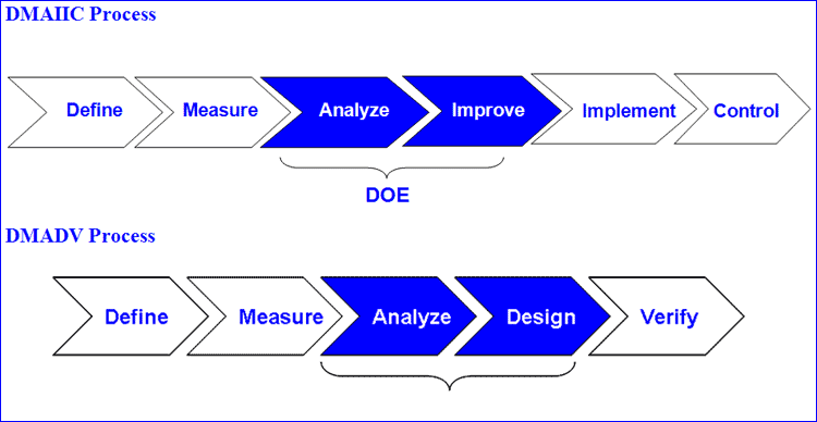

What is DOE? Why is it used? What are its benefits? Where does it fit within the Six Sigma process? DOE is much more than a set of experiments as the name may imply. The DOE activity generally occurs sometime during the analyze and improve phases of the define-measure-analyze-improve-implement-control (DMAIIC) process. DMAIIC is a rational decision-making process for improving existing processes. DOE also occurs during the analyze and improve phases of the define-measure-analyze-design-verify (DMADV) process. DMADV is a rational decision-making process for building new processes (See figure 1).
