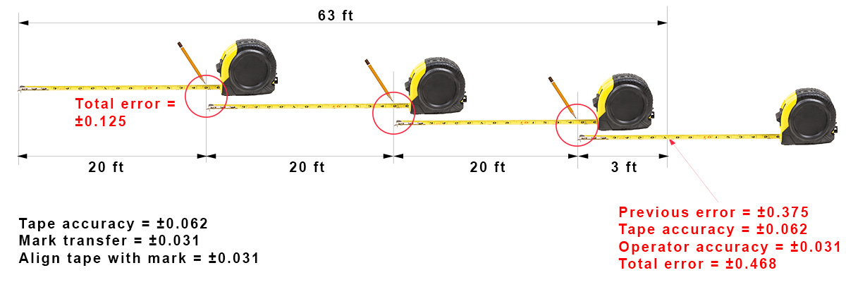

Figure 3 shows a simple example. We need to locate a point 63 feet from the end of a wall. If we had a high quality 100-foot steel tape, we would just measure 63 ft directly and know that we are accurate to less than one-quarter inch… the accuracy of most 100 ft professional tapes.
Figure 3: Just like part tolerances, measurement tolerances can also stack up.
But suppose all you have is a 20-foot tape with an accuracy of about one-sixteenth inch (0.063 in.). You will have to make four back-to-back measurements in order to measure 63 feet. However, each time you make one of those moves you are adding three sources of error: tape-measure accuracy of 0.063 in., how accurately you marked the wall with your pencil at the 20 ft mark—call that 0.031 in (about one-thirty-second inch), and how accurately your measurement assistant holds the end of the tape at that mark so that you can extend the tape another 20 ft— call that an additional 0.031 in.
Each time you move the tape, you are adding about one eight inch (0.125 in.) of measurement uncertainty. Do that three times, and add the 0.063 in. tape accuracy and 0.031 operator accuracy for your last reading, and you have a potential of about one half inch error for the overall measurement. This doesn't even include error due to how tightly you pull the tape or even the outside temperature... which also affect the accuracy. Who knew measuring could be so hard?

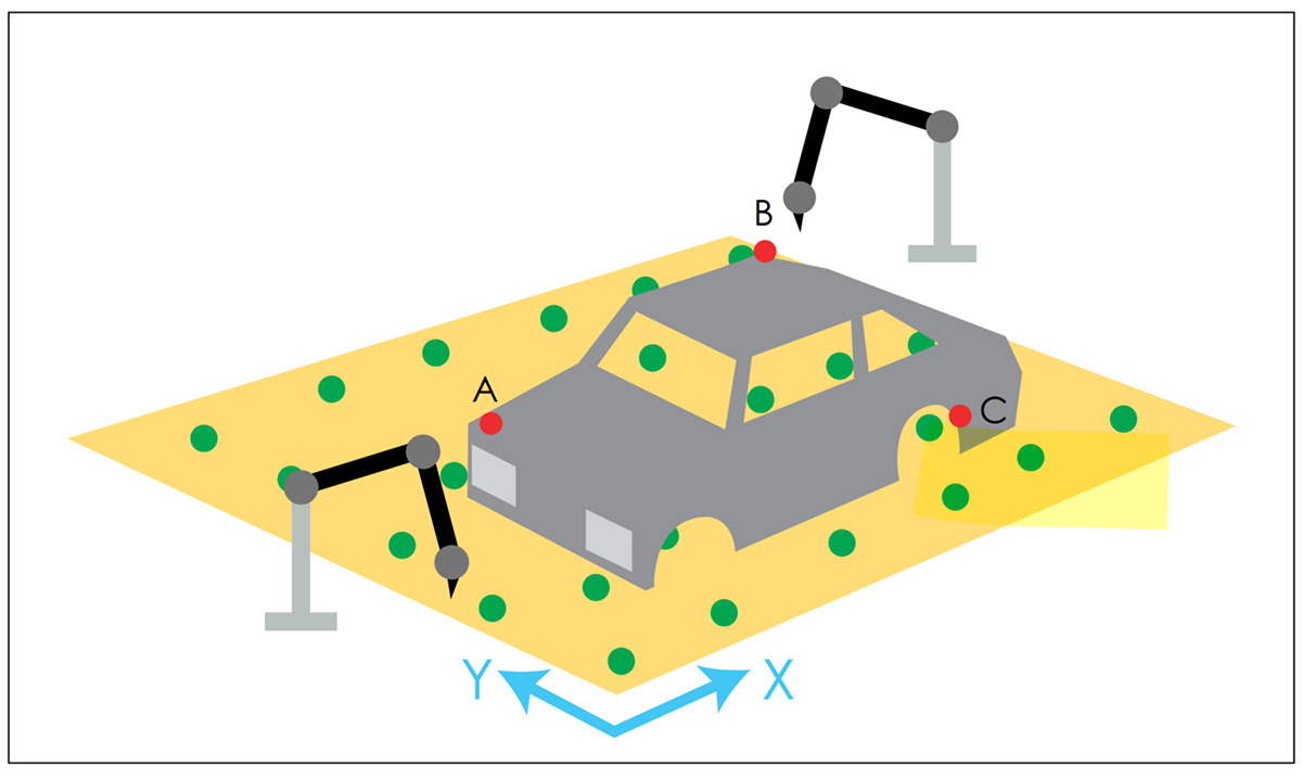

Figure 4b: In order to measure the entire frame it might be necessary to “leap-frog” the FaroArm around the frame, adding a small amount of measurement uncertainty.
This kind of error can also happen in a manufacturing environment when measuring large objects, such as an entire car frame or an aircraft wing. In those cases it’s often necessary to leap-frog measurement equipment.
Figure 4a shows a Quantum X FaroArm portable measurement arm. This particular FaroArm has a length of about 2 m (6.6 ft), which means a measuring envelope of about a 12 foot sphere,  with an accuracy of 23 microns (0.0009 in.).
That’s the accuracy from a measurement taken at one location. But suppose you use the arm in two locations in order to measure the entire car frame (see figure 4b). Each time the arm and its base are moved, the measurement uncertainty increases.
The uncertainty can be calculated, and depending on the purpose of the measurement, the extra uncertainty introduced by leap-frogging may not matter, but it does have to be understood.

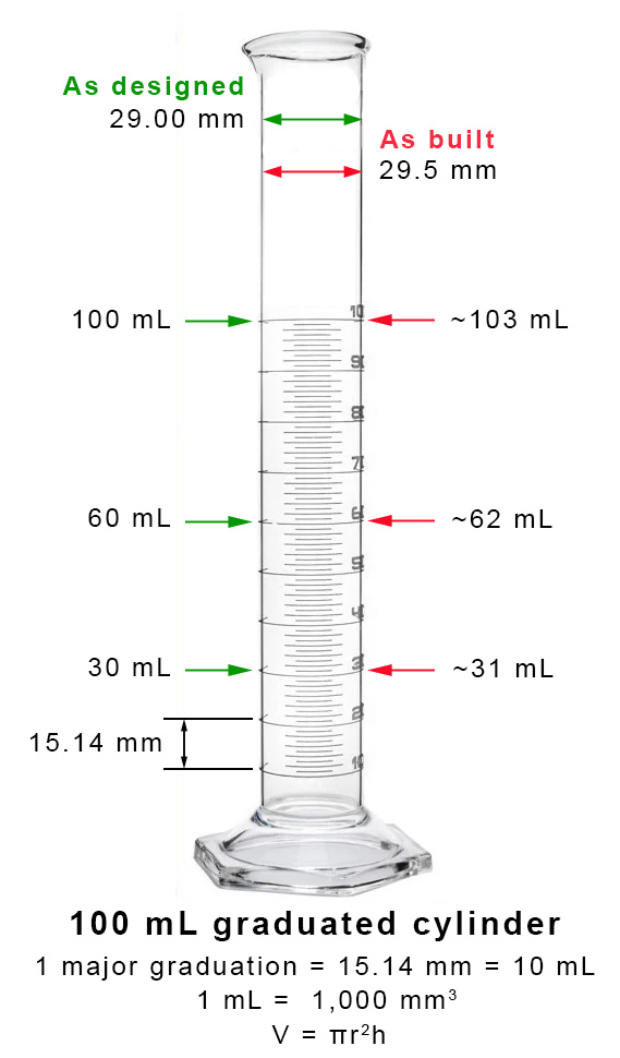

Figure 5: A small difference in the diameter of this graduated cylinder will cause a significant error in the reading as you measure greater and greater volumes.
In figure 5, we have a graduated cylinder, used for precise liquid measurement. These are made to exacting standards where the inside diameter and distance between marks are tightly controlled. In this 100 mL graduated cylinder, the inside diameter is 29.00 mm and the distance between major marks is 15.14 mm. With a Class B graduated cylinder, the final accuracy of the cylinder should be 1 mL, or 1% at full scale, for a Class A cylinder, it is 0.5 ml, or 0.5%.
Suppose during set up or inspection, the person measuring the inside diameters (ID) of a batch of cylinders is off by 0.5 mm or 500 microns; the inspector reads the ID as being 29.00 mm but in reality it is 29.5 mm and he passes the batch.
That difference is about the thickness of a high-quality business card, but when that error is plugged into the equation for the volume of a cylinder, it translates to about a 3.5% error. That means that at 30 mL, your reading would be off by 1 mL, at 60 mL the error would be about 2 mL, and at 100 mL the error would be greater than 3 mL, three times the stated accuracy of the graduated cylinder. All due to an error no bigger than the thickness of a card.
