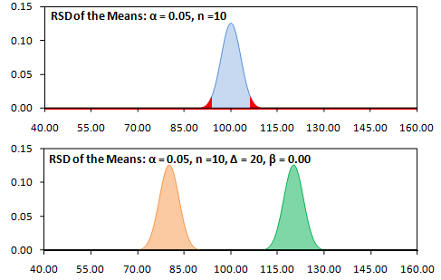

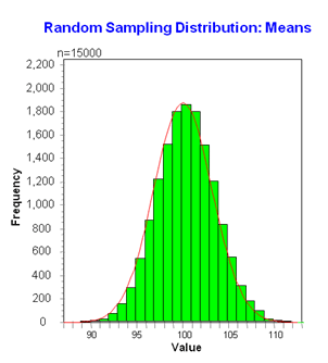

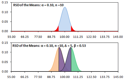

Last month I wrote about how the random sampling distribution (RSD) of various sample statistics are the basis for pretty much everything in statistics. If you understand RSDs, you understand a lot about why we do what we do in hypothesis testing, inferential statistics, and estimation of confidence intervals. Understanding RSDs gives you a huge advantage as you seek to use data in business, so let's take a closer look.
First, a brief refresher from last month. We have the big honkin' distribution (BHD), which is the distribution of the entire population of interest as shown in figure 1:
Figure 1: Big honkin distribution (BHD) of the entire population of interest
