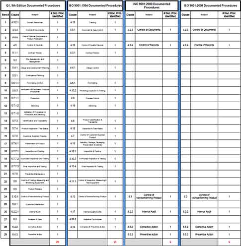

The fifth edition of ISO 9001, which is slated for publication in late 2015, has some good ideas regarding improvement and harmonization with other management system standards such as ISO 14001. However, ISO/Draft International Standard (DIS) 9001:2015 has taken away prescriptive language for a documented quality manual and documented procedures, and has minimized several important requirements that were in ISO 9001:2008.
This lessening of requirements will put additional pressure on service companies, manufacturers, and supply chain and quality organizations in the oil and gas industry. For example, if determining an organization’s level of conformance to a standard is placed into the hands of certification auditors, there will be inconsistencies. The variance between auditors and certification companies is not standardized.

You say that (API) Specification Q1 has "prescriptive language for an organization to document and implement a quality manual and a minimum amount of QMS procedures. Once implemented, the documented QMS will correlate to API product specifications when there is a requirement for a documented procedure and for purchasers’ technical contractual requirements". You just said you have a problem with the reduced requirement for documentation in the new standard yet specifically point out that API Q1 requires "a minimum amount of QMS procedures".  A bit of a contradiction. Secondly, the standard covers product specifications under 8.2.2 Determination of requirements related to products and services and then under 8.2.3 Review of requirements related to products and services which is very specific and detailed around the requirements. It even states that "where the customer does not provide a documented statement of their requirements, the customer, requirements shall be confirmed by the organization before acceptance". Oh yes, let's not forget that requirement for a change management system.
