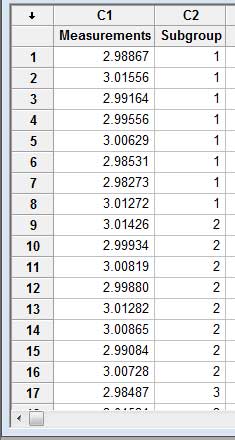

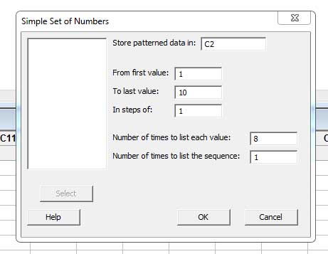

It’s your first day at the Jedi Temple, working as a lightsaber manufacturer. Your first task on the job is to run a capability analysis on the length of lightsabers being produced. Your main concern is to see if the lightsabers fit within the required length specifications set forth by the Jedi Council. You aren’t quite sure where to start. Thankfully, Minitab Statistical Software is there to help you—even in a galaxy far, far away.
Capability analysis is used to assess the capability of an in-control process. A “capable” process is able to produce products or services that meet specifications.
Book Preview
