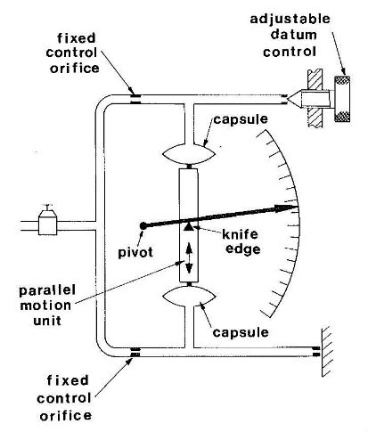

The circuit shown in figure 7a is a differential back-pressure circuit in which accuracy is maintained regardless of some variation in the regulator performance that controls supply pressure. This is now obsolete.
Figure 7b shows a differential back-pressure circuit with solid-state differential pressure transducer, which is the gold standard of differential back-pressure air electronic converters.
Figure 7a: Differential back-pressure circuit (Burrows figure)
