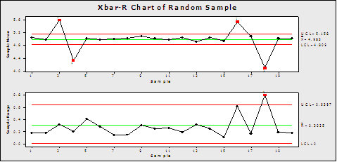

I guess I missed something. I see a "trimodal" distribution. And the X-Bar/R Charts appear very similar in shape. At least it appears that no matter what sampling plan was selected, both ended up with similar results. I think only one point different(?)
It appears to me that the sidemodes are from the early groups and last sample groups. Given these data, I didn't see much of a difference in the charts or analysis presented -- enough to draw a conclusion that subsampling change had any impact at all.

First, I don't think you missed anything, Dan. The little piles of data above and below the center pile are from the data in the high and low "out-of-control" points on the Xbar-R charts.
Secondly, I'm glad we have an article that talks about rational subgrouping; this is an important subject that deserves a lot of discussion, especially these days when there are too many Black Belts and Master Black Belts who have too little understanding of SPC. However, these examples may not be the best to illustrate the concept.
For one thing, sampling theory as usually practiced for enumerative studies may be completely irrelevant in analytic studies; monitoring process data over time for SPC usually falls under the latter type. There is no underlying population. There may be a pile of historical data, but our task is not extrapolating from a smaller samples to characterize the population, it is to extrapolate from the past to the future. The population of interest does not exist, and never will.
The control chart indicates that we do not have "normally distributed data." You never actually have normally distibuted data, but when you have an out-of-control condition, you can't say anything at all about the distribution; without homogeneity, there is no distribution. In fact, what we appear to have in this case is maybe three different distributions. Further study within the lots to find out whether they are interenally homogeneous might be helpful, as one of the primary goals of rational subgrouping is ensuring internal homogeneity.
You could, I think, make an argument that either scheme discussed here might work. While it's true that the chart for "last five" reveals one extra assignable cause signal, the chart for the "random sample" has a smaller R-bar, thus tighter limits; it may, therefore, be more sensitive and stand a better chance of revealing other signals over the long run.
