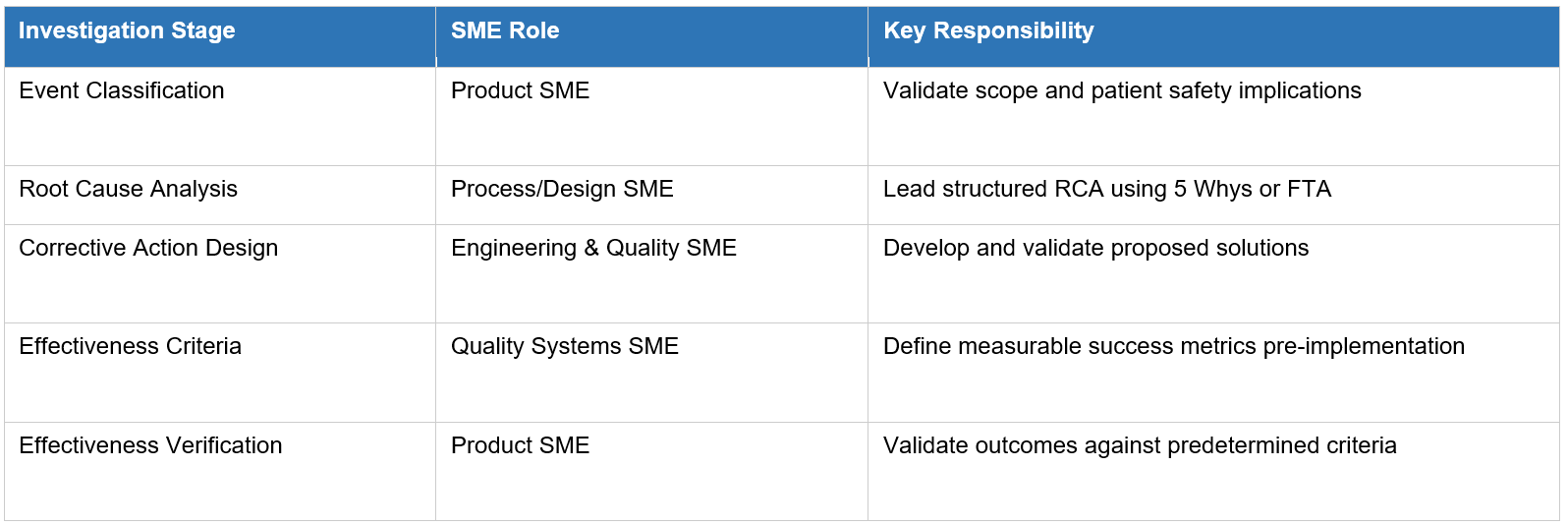

RCEF Stage 2: SME-driven investigation
In standard CAPA processes, investigation teams are often assembled from whoever is available rather than whoever is most qualified. The RCEF requires formal SME designation at each investigation stage.
SME involvement isn’t advisory; it’s structural. Each stage has a designated SME owner who is accountable for the quality of that stage’s output before the investigation advances.

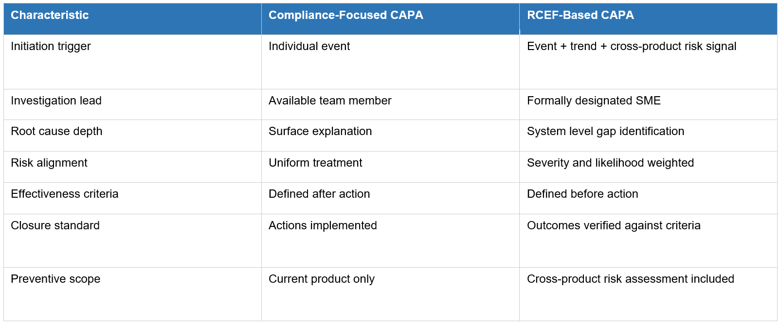

What effective CAPA looks like
An effective CAPA system has several defining characteristics that distinguish it from a compliance-focused documentation exercise.

These changes address the most common CAPA failure points and build a foundation for a quality system that genuinely improves over time rather than simply documenting that it tried.
