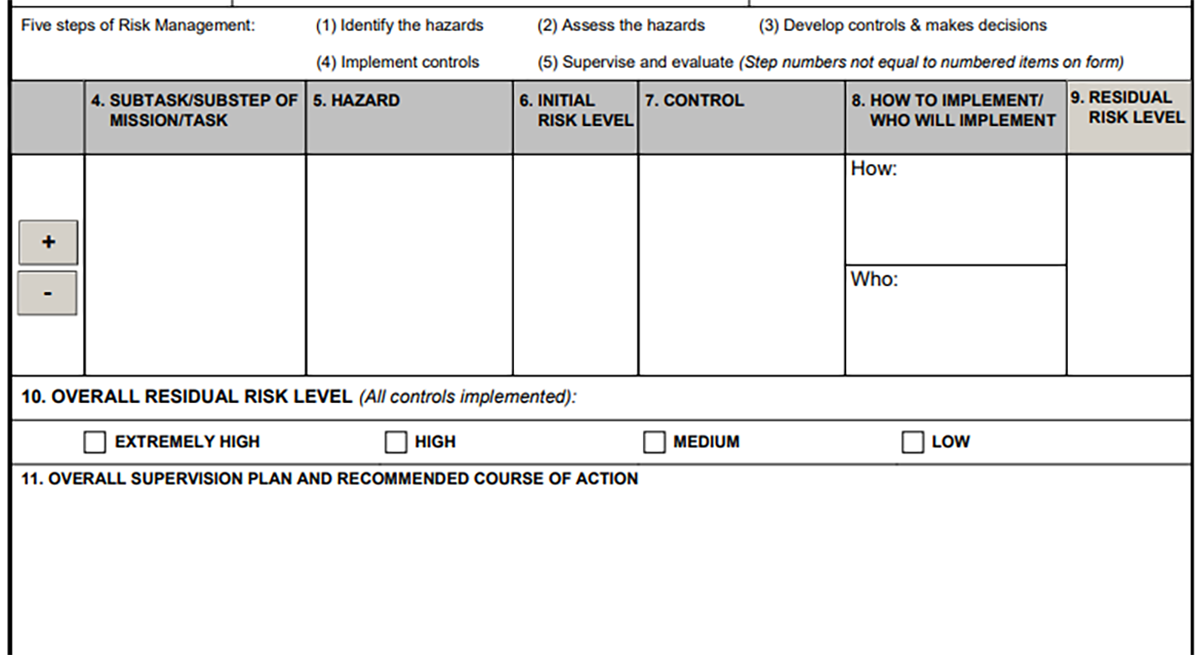

DD2977 begins, as do other risk management processes, with identifying the risks and whatever controls we already have in place to address them (Figure 1). Failure mode effects analysis (FMEA) breaks the latter down into prevention and detection controls. Prevention controls seek to disable the failure modes and their causes, while detection controls identify and intercept nonconforming work before it can reach an internal or external customer.
Figure 1: DD2977 risk identification and controls

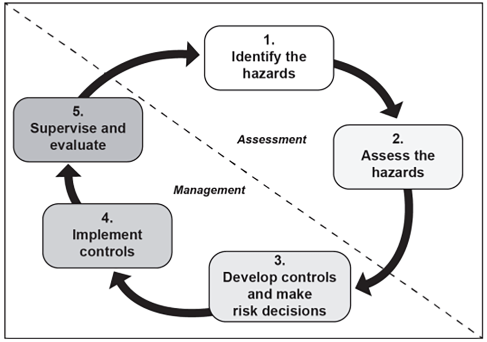

Note also the five steps of risk management: 1) Identify; 2) Assess; 3) Develop controls and make decisions; 4) Implement; and 5) Supervise and evaluate. These appear in Figure 2 from ATP 5–19, which adds that risk management practitioners “need not be highly trained in RM or safety to apply these steps.”
Figure 2: Risk management process from ATP 5-19

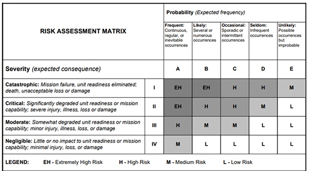

We then use DD2977’s risk assessment matrix (Figure 3) to classify the risk level. If we’re assessing a workplace safety risk that can cause death, but it’s unlikely to happen, then the Severity level is Catastrophic, and the expected frequency is Unlikely. The risk level is Medium because a risk with a potentially fatal outcome can never have a risk level below Medium if the event is remotely possible.
Figure 3: DD2977 Risk Assessment Matrix
If the risk level is unacceptable, then controls must be improved to reduce it and get a lower residual risk level in Field 9, as shown in Figure 1. This is the same approach used in FMEA. However, the AIAG/VDA FMEA Handbook (AIAG 2019) awards an Action Priority (AP) rating of Low if an activity’s Prevention controls make the failure impossible—as in “Never,” rather than “Unlikely.” Even with Severity and Detection ratings of 10 (worst possible), an Occurrence rating of 1 (best possible) results in an AP of Low.
As an example, connecting an enteral feeding tube to an intravenous line is likely to cause death or serious injury (DD2977—Catastrophic, FMEA—Severity 10), and numerous fatalities have resulted from this. Nestlé’s SpikeRight enteral feeding tube connector is designed to be physically incompatible with intravenous lines. The video is an excellent illustration of poka-yoke or error-proofing. The “No IV” symbol on the bag tells the nurse, “Don’t connect this to an IV line.” The design of the connector system says, “You can’t connect this to an IV line.” This exemplifies Ford’s “Can’t rather than don’t” safety principle. If the failure is physically impossible, the Occurrence rating should be 1.
This article therefore recommends a modification of the DD2977 Risk Assessment Matrix that adds a Frequency column for “Never,” whose requirement is the same as AIAG/VDA’s for an Occurrence rating of 1; “Failure eliminated through prevention control and failure cause is not possible by design” (page 65 for Design FMEA) or “Failure Mode cannot be physically produced due to the Failure Cause” (page 111 for Process FMEA). A frequency of Never will always result in a risk level of Low. We’ll also add a frequency column for “Always,” which pertains when an inefficiency is built into a job. This puts the risks associated with failure to act on opportunities into an entirely new perspective.

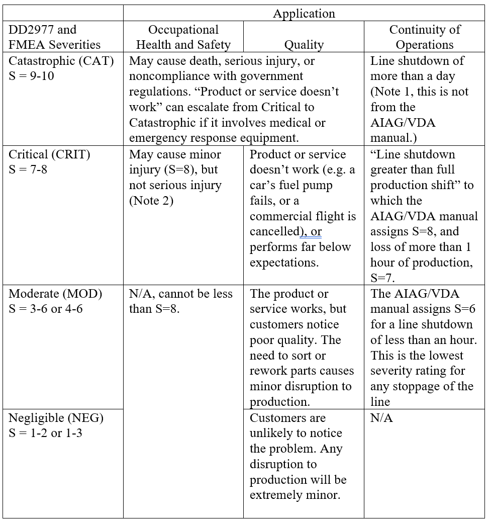

Severity rating conversion
The first step is to convert the FMEA Severity ratings, when available, into DD2977’s ratings, as shown in Figure 4.
Figure 4: Severity rating conversions
Note 1: A higher Severity rating is up to the discretion of the user. For example, 9 and 10 are generally reserved for risks to safety and regulatory compliance. But these aren’t relevant to continuity of operations, for which we need consider only economic risks. We must also recognize the force majeure that keeps us from receiving purchased items (including electricity) or meeting the needs of our own customers can easily affect our continuity of operations.
Note 2: DD2977 allows moderate and negligible severities for minor and minimal injuries. The AIAG/VDA Handbook doesn’t permit a severity rating of less than 8 for anything that is safety-related.

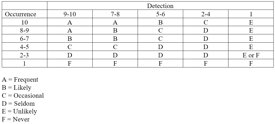

The next step is to convert FMEA’s occurrence and detection ratings (if available) into DD2977’s probability ratings. The middle of Figure 5 is open to some interpretation and modification, although the upper left corner is not. If the occurrence rating is very poor (8 to 10), the prevention controls aren’t adequate and problems will occur. If the detection controls are similarly inadequate, then the problems won’t be intercepted before they can reach customers, injure workers, or disrupt operations. We must classify these situations as Frequent. If the occurrence rating is 1, however, the failure can’t happen. The AIAG/VDA Handbook assigns a risk priority of Low when O = 1, even if S = 10 and D = 10, so we can assign a probability of Never.
Figure 5: Convert FMEA occurrence and detection to DD2977 probability
The FMEA/VDA manual gives more weight to Occurrence than Detection, but it also says (page 113) that D = 1 requires the detection control to “ALWAYS detect the failure mode or failure cause.” Unlike O = 1, D = 1 doesn’t result in an automatic Action Priority of Low. A combination of D = 1 and O = 3 or less delivers AP = Low (pages 116–117) regardless of the severity, which could allow a probability of Never for this combination as well.
Here’s a supply chain and continuity of operations example. Suppose the Susquehanna River can overflow its banks to flood an automotive supplier. If this can lead to an extensive line shutdown at the automaker, we might assign a Catastrophic severity. If the flood probability is seldom (D), then our risk level is High. If a levee is built to contain the river, then the probability is reduced to Unlikely and the residual risk is now Medium.

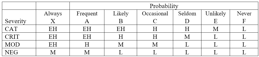

Suppose we have a job design that might waste a certain amount of labor. This doesn’t risk safety, quality, or continuity of operations, but there’s a serious risk associated with failure to remove the waste. If the waste is present, then the probability is 100% (Always) because the waste is built into the job. Using DD2977 in this application requires an augmented risk table, as shown in Figure 6.
Figure 6: Augmented DD2977 risk table
The optional column for Never deploys the AIAG/VDA FMEA Handbook’s position that an occurrence rating of 1, which means the failure can’t be produced, delivers an action priority of Low even if the severity and detection ratings are both 10.
When it comes to opportunities, though, we must add a column for Always. If we use Ford’s example of the absence of a device that would save 10% of time, the activity in question is always subject to a 10% tax. If brick layers must always bend over to pick up bricks and mortar, then their job always wastes 64% of their labor. If strawberry pickers must always bend over and walk to do their jobs—and Henry Ford wrote that no job should ever require anybody to bend over or take more than one step in any direction—then the job always wastes labor. The only question is how much.
The next step is to classify the severity of missed opportunities, and this is largely up to the judgment of the user. Is a 10% inefficiency Negligible or Moderate? If it relates to labor, 10% is 48 minutes out of every 8 hour work day. An inefficiency of 64% rises to the level of critical or even catastrophic. We’re paying almost three people to do one person’s job, which means we’re paying them less than they should earn and charging our customers more than they should pay.
