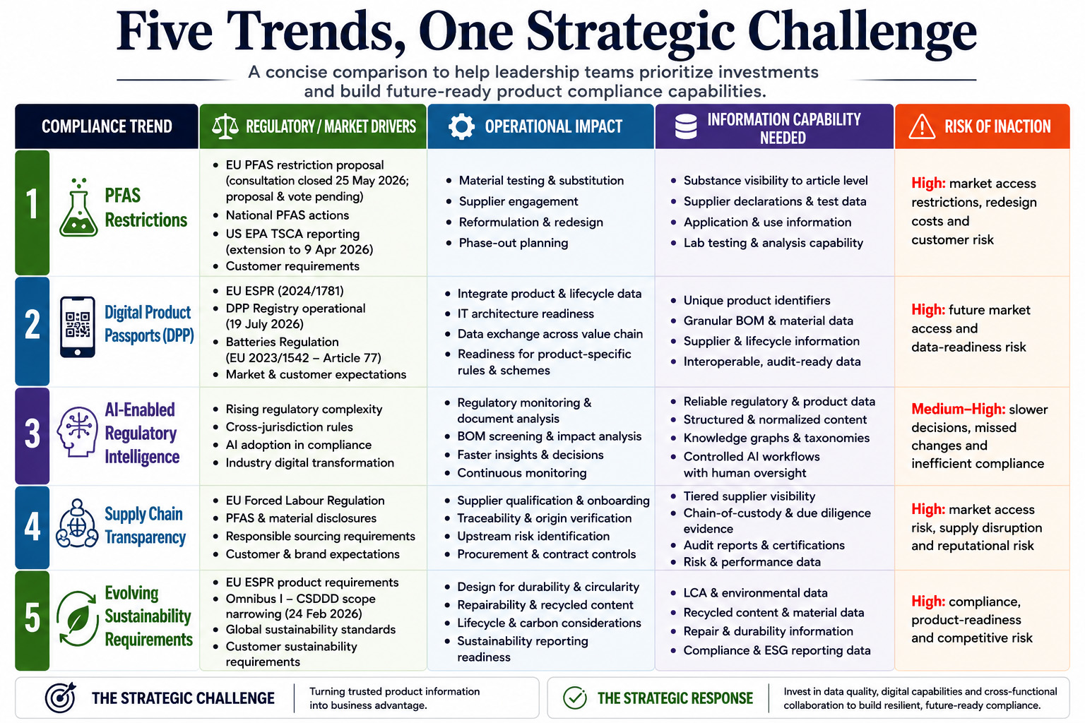

Product compliance is moving beyond certificates and restricted-substance checks. PFAS restrictions, digital product passports, artificial intelligence, supply-chain transparency, and sustainability increasingly require manufacturers to connect regulatory knowledge with reliable product, material, and supplier data.
From compliance documents to product intelligence
When I began working in electronics nearly three decades ago, environmental compliance was relatively linear: Identify a regulatory change, contact suppliers, review evidence, update product status, and retain the records. That model still matters, but it’s no longer enough.
Regulations increasingly ask questions that a finished-product certificate can’t answer. What substances are present inside a component? Where did a material come from? Can the product be repaired or recycled? What evidence supports a sustainability claim?
A bill of materials (BOM) identifies components but might not reveal the chemical composition of coatings, adhesives, or polymers. A supplier declaration is useful only if it’s current and linked to the correct part, supplier, and revision.

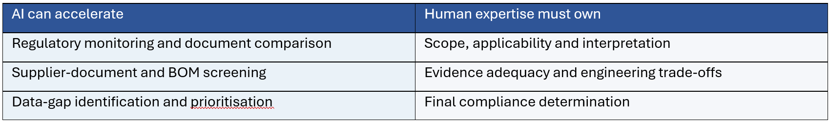

Thank you, Greg. I really appreciate your perspective, especially given your extensive experience in component supply chain management. You’ve captured an important point from the article: AI can significantly improve the speed and scale of regulatory intelligence, but experience and human judgment remain essential for interpreting applicability, evidence, and accountability.

Thank you for sharing such a detailed real-world example. The PVDF case illustrates exactly why regulatory interpretation cannot stop at an idealized chemical structure or an AI-generated answer. Manufacturing realities, such as chain defects, can change the classification entirely.
This is a great reinforcement of one of my article’s key points: AI can accelerate the analysis, but the underlying regulatory definition and technical evidence still need to be evaluated and validated by someone with the right expertise. As you note, the devil is often in the technical details.
