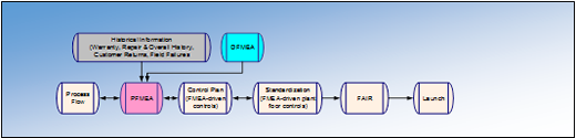

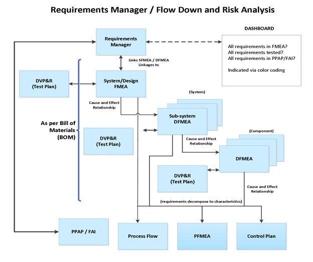

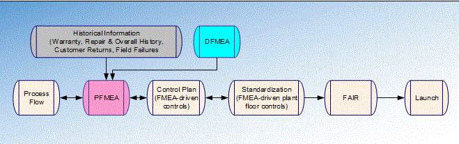

Quality improvement and defect prevention start with a disciplined, new-product development process that includes phase gates. Most important, three tools are key to overall success:
1. Failure mode and effects analysis (FMEA) that is used with design and processes
2. Design for manufacturing (DFM) and design for assembly (DFA)
3. Upfront involvement of manufacturing in design
