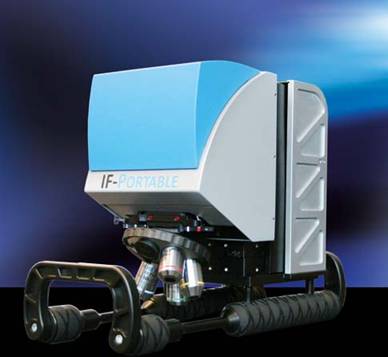

(Alicona: Bartlett, IL) -- Alicona is now marketing the IF-Portable (figure 1) and the Edgemaster (figure 2) for 3-D surface measurement. Both are based on Alicona’s FocusVariation technology.
The IF Portable is a mobile optical measurement system to measure form and roughness on larger surfaces. It is also used as a production tool for quality assurance. The Portable can be used to measure flat and curved surfaces. A key application is platen inspection in the print industry, but it can be applied to any task where small measurements on large surfaces are required.
Figure 1: IF Portable
