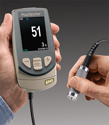

(DeFelsko: Ogdensburg, NY) -- DeFelsko has introduced the new PosiTector SHD Shore Hardness Durometer for measuring the indentation hardness of non-metallic materials such as polymers, elastomers, and rubbers. In the corrosion industry, durometers are commonly used to ensure proper curing of pipeline repair wraps. Two models are available for different hardness ranges—Shore A and Shore D.
Features include a digital display, a user-adjustable measurement time with onscreen countdown and an Auto Ignore mode that disregards readings below 20 and above 90 to comply with international standards. Other features include internal memory, statistics, and a USB port.
