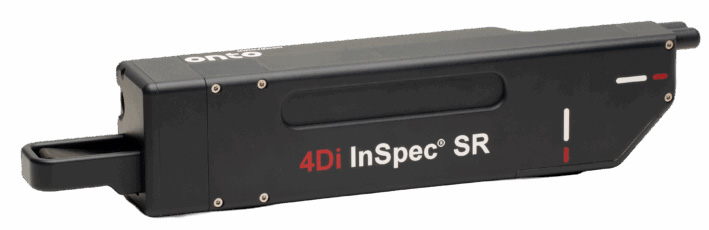

(Onto Innovation: Tucson, AZ) -- Onto Innovation’s Tucson-based subsidiary 4D Technology has announced the launch of the 4Di InSpec SR roughness measurement system—a novel, portable, vibration-immune optical system for high-precision 3D surface roughness measurement at the point of use.
The 4Di InSpec SR employs patented technology for rapid surface measurements unaffected by vibration. Rugged and easy to use, the system accurately measures roughness right on the shop floor in a wide range of environmental conditions.
The high-resolution 4Di InSpec SR measures Sa roughness in a wide range of environmental conditions down to 12 nm.
The high-resolution 4Di InSpec SR comes in multiple configurations, including tabletop, workstation-mounted, armature-mounted, or robot-mounted for fast, automated inspection of surface quality of large and hard-to-reach components.
Until now, companies have typically relied on 2D stylus-based systems or large microscope-based optical profilers that can be time-consuming and extremely sensitive to environmental factors, typically confining them to quiet lab environments outside of the shop floor.
The 4Di InSpec SR transforms how precision surface measurements are achieved by enabling surface finish and roughness measurements down to 12 nm Sa in seconds, right on the shop floor. The system can directly measure roughness on large components without the need for replication. Scratch-free optical technology eliminates surface damage, enabling measurements on most materials, including carbon fiber, metals, composites, plastics, and silicon.
With a roughness Sa accuracy of better than 0.5%, and its small portable form factor, the 4Di InSpec SR can measure in virtually any orientation to reach difficult-to-access locations, tight corners, and large surfaces on applications including:

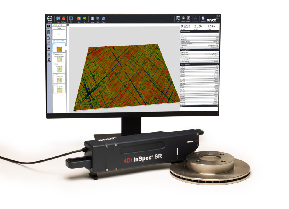

The system includes the robust 4Di InSpec SR software, which offers an intuitive touchscreen interface for setup, operation, analysis, and data transfer to quality control systems, and compliance with standard ISO filters and 3D roughness parameters, including S-parameters.
