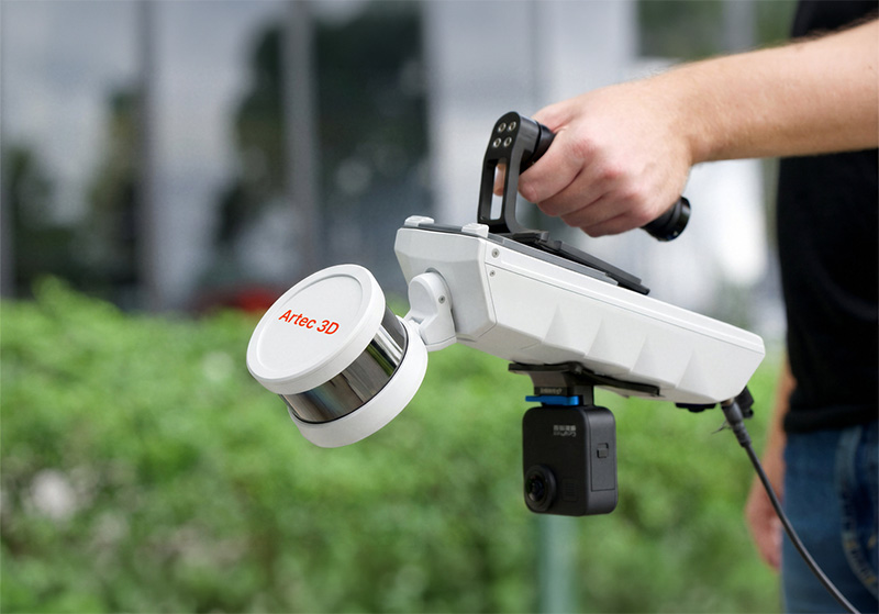

Artec Jet combines high-density LiDAR sensors and industry-leading SLAM positioning to capture with an accuracy of ±10 mm indoors and underground, while detecting small changes of just 5 mm, putting it among the best in mobile mapping. Users can improve global accuracy further with RTK accessories that enable GNSS-assisted georeferencing and reduce drift.
The device is also built to ensure that every scan counts. A dedicated companion app offers real time feedback and onsite verification. With a 360° x 290° field of view, users get the full picture—and the addition of optional video cameras brings full-color capture as well for maximum realism.

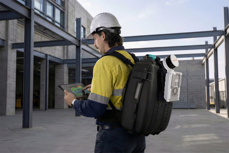

With seven deployment modes—handheld, backpack, drone, vehicle mount, protective cage, telescopic pole, and robotic integration—Artec Jet easily adapts to specific project needs.
Each modality delivers consistent, survey-grade results thanks to the scanner’s SLAM algorithms, which are robust enough to perform regardless of how it is deployed. The versatile nature of the device also makes it a single solution for any design challenge, capable of replacing an entire fleet of specialized equipment, even in demanding environments.

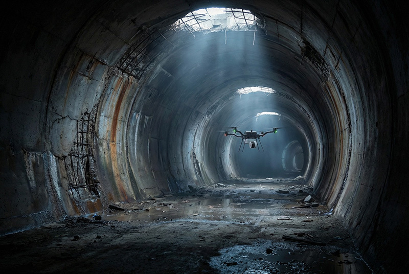

One of Artec Jet’s most transformative features is its ability to scan fully autonomously onboard a drone without any human input. Using advanced SLAM algorithms and AI-powered navigation, the device independently plans its own flight paths, avoiding obstacles as small as 2 mm wires, while maintaining stable positioning and continuing to acquire reliable mapping data.
This enables safe entry into complex, hazardous, or confined environments like tunnels and unstable structures, where manual piloting would put personnel in harm’s way. If battery levels drop below safe thresholds, the drone automatically returns to its launch point, ensuring both data integrity and operational safety via full end-to-end autonomous workflows.
