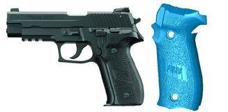

(NVision: Coppell, TX) -- A custom gun grip manufacturer has substantially improved the quality of its products by using the MobileScan HD portable 3-D laser scanning system from NVision to reverse engineer the original grips. In the past, the manufacturer used a coordinate measuring machine (CMM) to define the geometry of the mounting surface of the grips. But the CMM’s inherent accuracy limitations made it difficult to provide the desired fit and finish. The laser scanner, on the other hand, captures millions of points, making it possible to define the mounting surface to a much higher level of accuracy.
