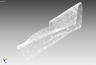

Point cloud
Description: Raw data that results from a single scan, or multiple aligned scans. Geometry is represented by a large number of individual data points. Unfortunately, this type of data is mostly useless unless you possess specialized scan-data processing software, which can be used to create polygonal, surface, and solid models.
• File Format: ASCII, TXT, PTS, PTX
