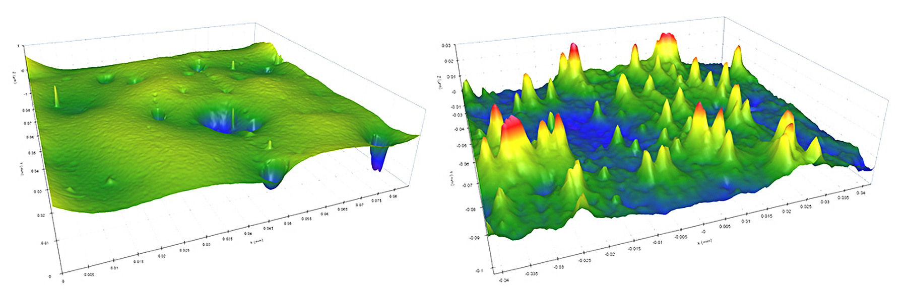

One of the primary advantages of optical instruments is that they typically produce 3D data maps. Seeing a surface in 3D can shed light on what’s happening in the texture much more readily than a single profile or a single parameter value. An areal (3D) measurement is more likely to capture surface features that might be missed altogether by a single stylus trace across the surface. The deepest or tallest portion of features such as tiny pits or nodules are also more likely to be captured by an areal measurement, allowing more accurate calculation of texture parameters. Moreover, certain 3D aspects of a surface, such as the volume of fluid that it can retain, can only be measured using 3D techniques.
A close-up of a green and blue diagram  AI-generated content may be incorrect.
Figure 5: Pits and pores can only be reliably measured from 3D/areal data. Courtesy Digital Metrology Solutions.
One shortcoming of optical measurement, however, is the size of an individual acquisition. A 3D measurement can appear to be a vast landscape, but in reality the measured area may be quite small. Figure 6 shows that typical optical 3D measurements may be much smaller than a standard 2D stylus profile. In most cases, an optical system configured at the same lateral resolution as a stylus instrument will produce an image that’s only about 0.5 x 0.5 mm.
