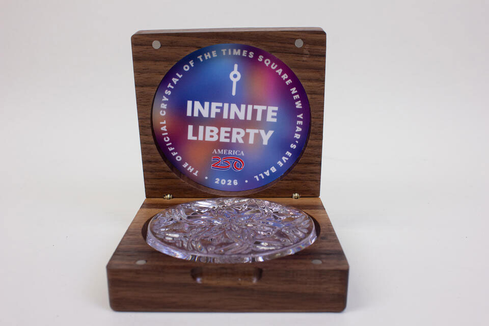

Berilla: Some of the items in the time capsule include crystals from the New Year’s Eve ball drop in Times Square, a signed joint letter from Congress, books, a cellphone, a coin-toss coin from an NFL game, and a message in a bottle.

A piece of crystal from the New Year’s Eve Ball in Times Square is among the artifacts placed in the time capsule. Credit: A. Boss/NIST
