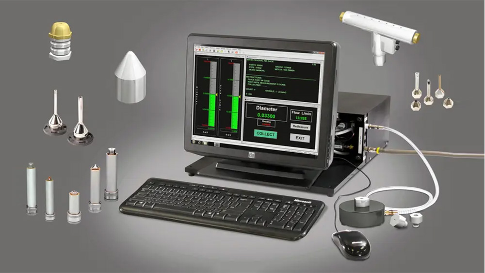

Some air gauges measure the rate of flow through the system rather than backpressure: As tool-to-workpiece proximity decreases, flow also decreases. The flow principle can be effectively applied to measure very small through-holes, even on air gauges that were designed to operate on the backpressure principle. Rather than installing tooling at the end of the air line, the workpiece itself is connected to the line. Smaller bores restrict the flow of air more than larger ones. Thus, the workpiece essentially becomes its own gauge tooling. This approach works on all common types of backpressure gauges—single-leg gauges requiring dual setting masters, as well as differential-type gauges, which typically use just one master.
Airflow is proportional to the bore’s cross-sectional area, but area varies with the square of diameter. Gauge response in this setup, therefore, is nonlinear. Nevertheless, this rarely causes problems because the range of variation to be inspected is usually very small and the gauge is typically set to both upper and lower limits using dual masters or qualified parts. Thus, a specially modified bench air gauge amplifier or pneumatic column gauge can be dedicated to measuring this small range.
However, the ideal gauge for the user has as much flexibility built into the system as possible. What this means is the ideal solution is to be able to measure anything within the 0.1 mm–1 mm range and thus eliminate the short-range dedicated system. To do this, there is the small equation we mentioned previously: Airflow is proportional to the bore’s cross-sectional area, but area varies with the square of diameter. Thus, if a long-range system is required, linearization is a must. Using two masters over the full range of the hole diameters would not provide the performance required. And there is one more issue. Most pneumatic sensors can’t be set up to handle the long range needed and still maintain the resolution and performance required.
With the use of a gauging computer in conjunction with a series of pneumatic transducers, each tuned for its own small range, the computer can sense where the sample part is falling in terms of flow with the proper pneumatic transducer and use that one for the hole measurement. Also, because each transducer has been linearized to correct for the squaring of flow for the size change, hole sizes can be measured to an accuracy of better than 7.6 µm.
With a linearized and multiple pneumatic transducer system, the operator can simply place any part onto the gauge and it will provide the hole diameter and the flow rate based on the pressure used in the system.
