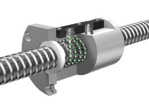

A ball screw converts the rotary motion of the screw into linear motion. Imagine holding a nut on a screw as you turn the screw. The nut will move linearly along the screw. The “nut” in the case of a force tester is the crosshead.

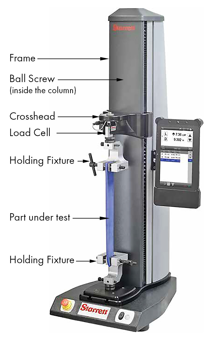

Starrett FMS 5000 force tester
At it’s simplest, a force tester consists of a frame (stand), a motor that turns a ball screw, and a crosshead that moves up and down either pushing (compression) or pulling (tension) the part under test. The crosshead holds a load cell—an electromechanical device that converts force into an electrical signal, and some sort of gripper or fixture to hold or push against the part under test. The signal from the load cell is sent to a computer for processing and display.
Putting it all together, you have something that looks like the tester shown here. The motor turns the ball screw, which moves the crosshead and attached fixture up or down at a set speed. A rotary encoder attached to the ball screw precisely measures how far the crosshead travels. The distance the crosshead travels and the speed of travel are variables that can be set per the application. Depending on the type of test, the software will display results, calculations, and graphs in real time.
In the case of Van Steel’s spring rate test, the crosshead pushes into the center of spring, measuring the force through one inch of travel.
