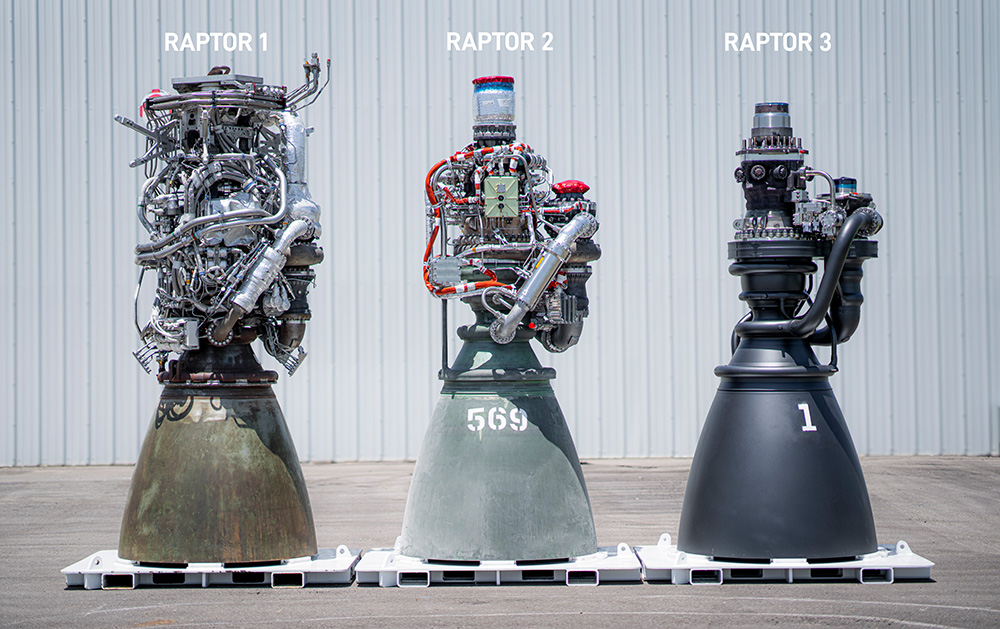

The engine that got emptier
Side-by-side photographs of the successive versions of SpaceX’s Raptor engine were met with astonishment when first published a few years ago. It was immediately evident that the same engine reached a more streamlined, distilled form. Many of the previously visible elements had vanished. Pipelines gone, plumbing and sensors moved, protective shrouds eliminated or integrated into the body of the engine itself. Three pictures, and what people saw was absence.
Credit: SpaceX
This result is precisely what happens when clever people iterate quickly and efficiently. This is true enough, but it skips something: The achievement per se was not addition but, rather, subtraction. And subtraction is the harder of the two.
The removal of a part or a subsystem requires that its function is thoroughly known and understood. It means knowing what the old part was doing all along: every condition it covered, every failure mode, every interaction and allocation. You can’t safely delete what you don’t fully understand. Which leads to an interesting diagnostic point: A system that has become simpler over time is usually a system that is now better understood.

Subtraction may be driven by knowledge, starting from a deep understanding of the system at hand. Decisions are made considering the system as a whole, tracing subsystems and components back to their function. Demonstrating that a control element now guards against a condition that no longer exists or that’s now covered by another safeguard requires full ownership and responsibility. This is precisely what happened to the Raptor engine.
